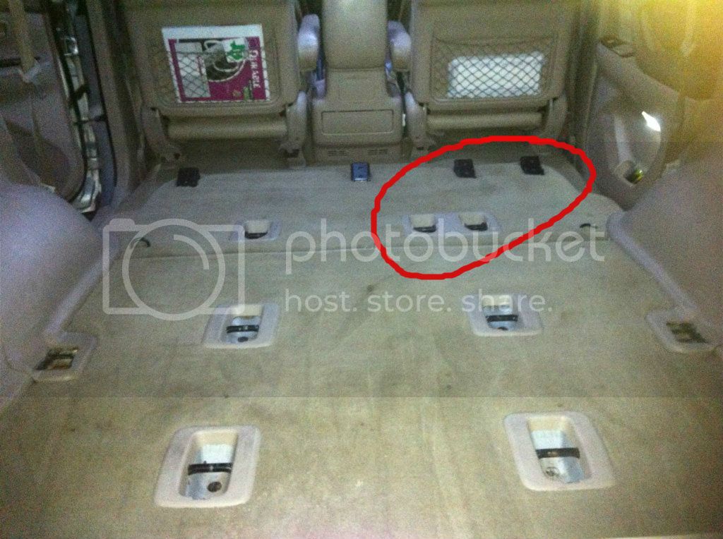

I'll have to double check the heat shield. The brackets in question are the front mounted ones that the seat bolts into and the bar ones that they lock into when folded down.

These are the brackets in question

The red circle on the picture is right above where the catalytic converter is located. The catalytic converter uses catalyst to facilitate the oxidation of unburned fuel in the exhaust, with heat as byproduct. If your air:fuel ratio is rich, then the cats will crank out lots of heat. They also seem to burn hotter with age. They have heat shields for a reason. Hot is normal, but super hot could cause a problem.
Maybe look under there near the end of your next long trip and see if anything is smoking or glowing red. I think the cat should operate at about 500 deg F. If you have access to a decent infrared thermometer, it might be worthwhile to take a few readings next time you get the truck warmed up and i.d. the heat source.
