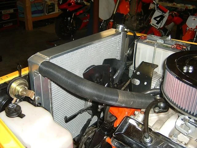

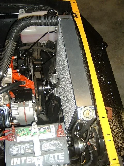

here's a couple pics of my top hose. If you have something in the way such as an AC compressor/other then you may have to bend some wire and bring home a few from the parts store. Here's a link with some pics showing what I mean.

Good data, but I've got the serpentine belt system on the ramjet. I'm not sure the hoses will fit over my alternator.
I see what you mean with the alt looking at pics in your build thread. The bottom should work. For the top I would start with a top hose for whatever that engine came out of. That certainly has to address routing around the alt.
Another thing you may want to consider doing is to bend up a pipe and use a length of hose at each end for the connection.

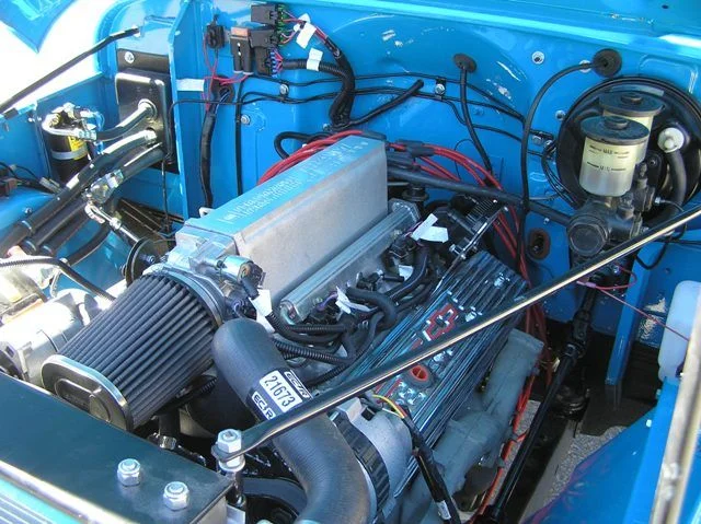

Top fitting is 1 1/2 inches, and bottom is 1 5/8. I also found this picture while surfing V8 installs. This one looks about perfect, now if I can only cross it.
jC
That's amazing. I wasn't able to recall where I found the picture, but the work is excellent. Any data that you could come up with would be much appreciated.

My shop did the installation of the ram jet in the blue FJ45 that is posted in Cirbo's photo. If you want, I can go back through my records and see if I can come up the the hose number for the bottom hose. The top hose is quite visable. My web site has a couple more photos.

Thanks for posting that pic on your site. I stumbled on this a while back and it was a life saver. I searched and searched for this top hose forever (with several HACK attempts of other hoses) and your pic made it easy.
