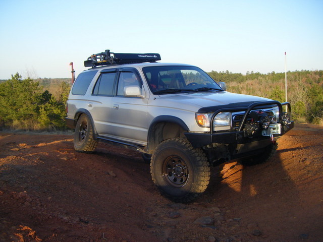

Here is a 98 4runner I bought a few weeks ago, I used TOYTEC coilovers and factory FZJ80 front springs in the rear.

Those gave me about 3" of lift. I just pulled those and put in some OME861 springs. The LC coils were too soft for my taste. I keep about 150 #s of tools and spares in the rear. I also have a heavy rear bumper and swing away. I will also have a fridge in the rear when the new ARB fridge arrives.
The OME 861 spring seems to be a good fit for my needs. The 861 is a low height heavy duty front spring for the 80 series, the spring rates are slightly higher the the 891(OME heavy duty 4runner coil) but a couple inches taller. I now have about 4"s of rear lift over stock. The truck should sit about level with the rear loaded and trailer hooked up.
