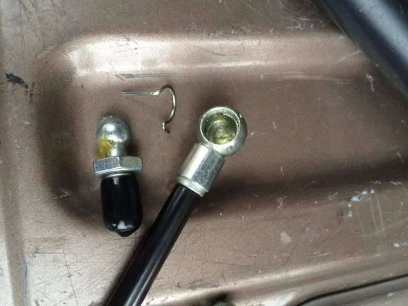

Well, THAT was a nightmare. I don't know if it was my just model (1988 FJ62) or maybe they were replacement struts, but there was NO WAY those studs were coming out of the old struts. And for those not paying attention to all the posts in this thread (like I didn't) the new struts (McMaster 4138T56) may advertise a 10mm ball, but that it on a std 5/16-18 thread, NOT the metric 8x1.25 you need, so you HAVE to pull the old studs or buy new ones. Having started the project I did not want to wait for new studs (found some here for anyone who decides to make their life easier: http://www.liftsupportsdepot.com/hardware-ball-studs/ball-studs-8mm-standard-types/) so I ended up unbolting the old struts, clamping them in a vice, and grinding 1/3 of the socket down until I could get needlenose pliers on the retaining ring that was in there, at which point the ball would pop out. Repeat for 3 more times in 30 degree weather. Grrr. Installation for me was easiest to pop in the bottom first, then hang on the top to pull it down & pop on the top stud. Those 90lb'ers really do the trick now though!
