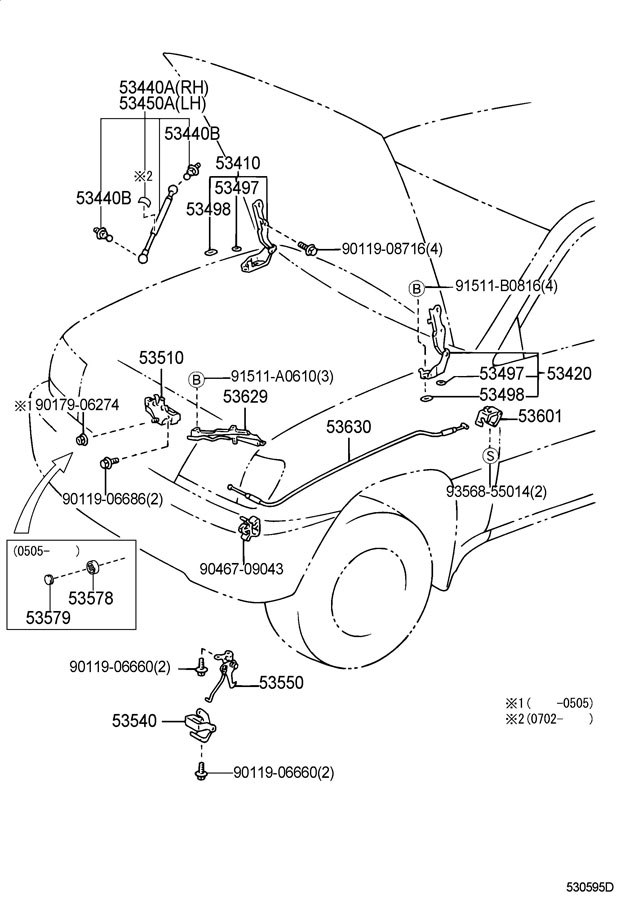

The in-cabin pull tab and cable are intact but the cable under the hood at the latch assembly is disconnected. What is the best way to open the hood? 2000 LX 470
The cable may not have broken...the plastic mount that attaches to the grill is a piece of junk and broke on mine. 53540 broke on mine:
