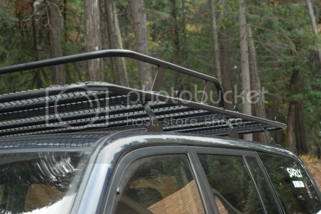

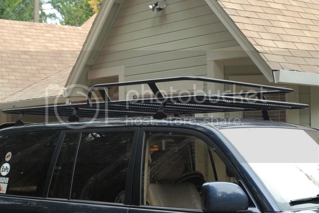

Finally got my rack dialed in for the 100! Thing is huge. Workingclass designed and did most of the work, I just grabbed tools and learned.

It looks like it is mounted a little high, is there a reason for the extra space between the roof and the floor?

It looks like it is mounted a little high, is there a reason for the extra space between the roof and the floor?[/QUOTE ] The towers were originally designed for 60/80 series or any rig that has rain gutters. I plan on a redesign to get the rack much lower somewhere @ an inch above the roof.
If you don't mind me asking what did you do all of your bends with? Bender wise?
Bender is produced by JD squared. Don't know much about it because it is not mine. It's a hand bender and works great!
Very cool, I have read a lot of good reviews on those and the ease of use. They have some good videos as well on "how-to". Appreciate the information. The rack looks cool I like how you did the raised front.
