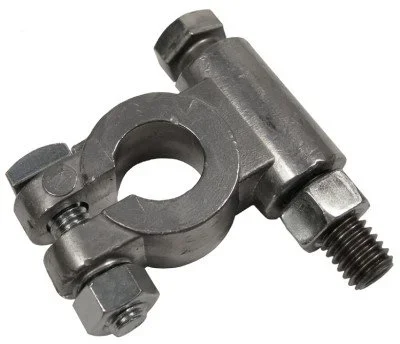

Holy S#!T!! Dealer Negative Battery Cable....
Is this what a military style connector looks like? I'm just curious. This is new to me. My negative cable needed replacing in a, relative, emergency four years ago and they didn't have a cable that would tighten down to my odyssey battery, I wedged a penny in to fill the gap. :hillbilly:
I like the idea of these and like the idea of being able to do something myself. I apologize for my ignorance. The main difference is that it is essentially a two piece design (having the cable screw to the clamp) rather than a one piece design where the cable is crimped to the clamp?
