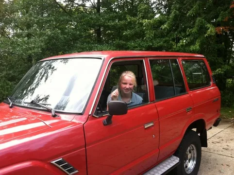

Here's my oldest in the 60. This was the first "Dad, can I have your truck when I am olde enought to drive?" moment. Had to dash her little heart! "Maybe a 62," I told her. "And if you misbehave, a Jeep."
Jeff...great looking 60! So Clean!
How is the undercarriage?
Fricken Pristine.
Glad to see you are still rolling around there Jeff
Thanks guys... You know, the undercarriage is not bad. Starting to get some rust on the frame, and I am not entirely sure how to approach it. Also have a small bubble emerging by the passenger side back window.
