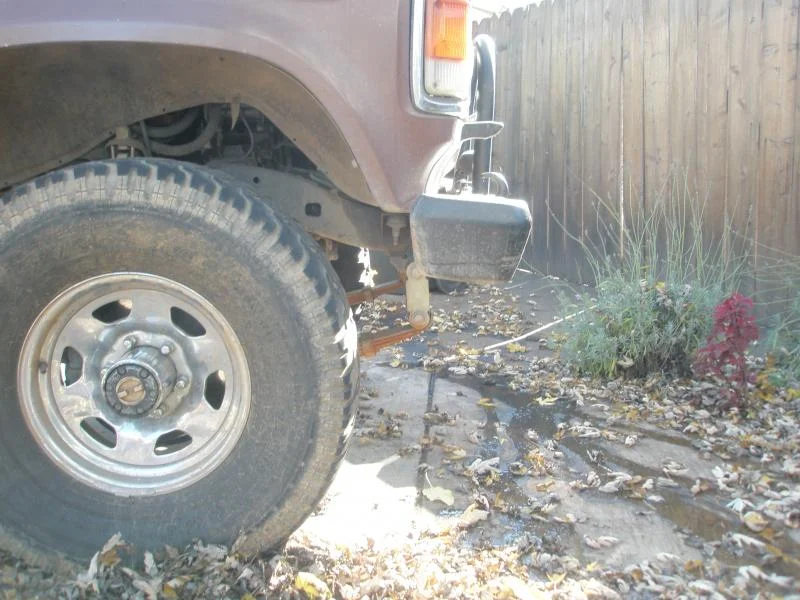

also heres a pic. how much do yah think my ride comfort will increase?
also hows my rear angle looken. i should probly shorten both?

I would do both. Other wise you will sag to the side you did. it will drop the rig a tiny bit, but will provide a small difference on your comfort of the ride. Hows she ride now? stiff?

No experience here so correct me if I'm wrong. Shackle angle here looks vertical:
attachment.php
Shorter or longer shackle isn't going to change angle will it? Looks like you need longer springs or relocated hanger?
