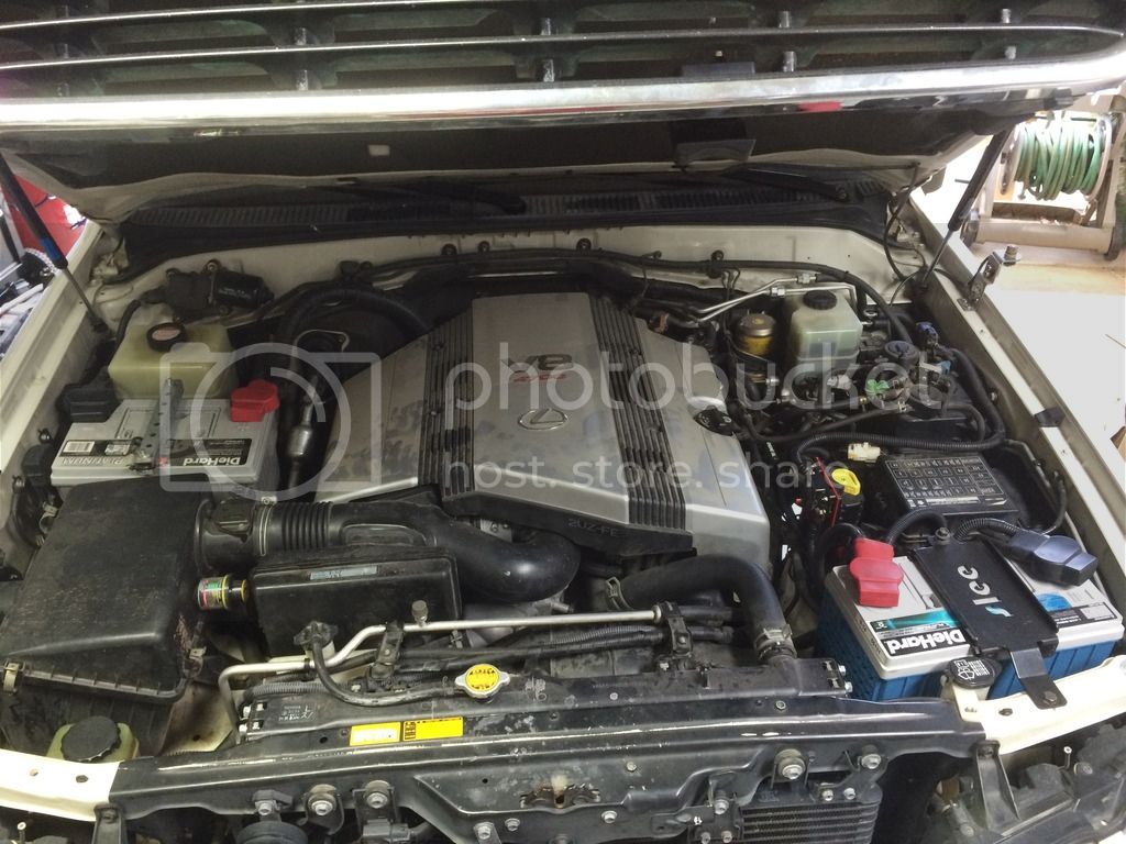

I am working out the best way to install my new DC Power engineering 180 amp HO alternator to replace the factory 100 amp. I already have dual batteries, 1 DHP group 31m for added circuits and 1 DHP group 65 as the starting battery and for OEM circuits. I have everything wired through a Blue Sea ACR.

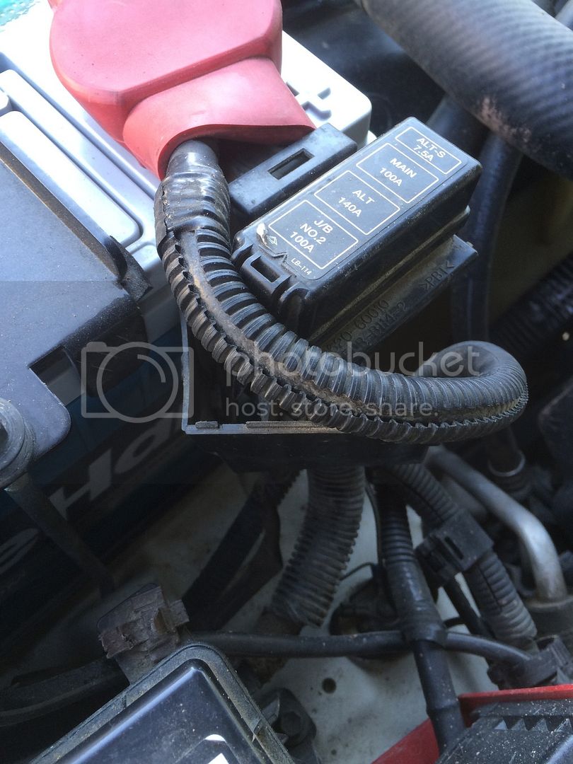

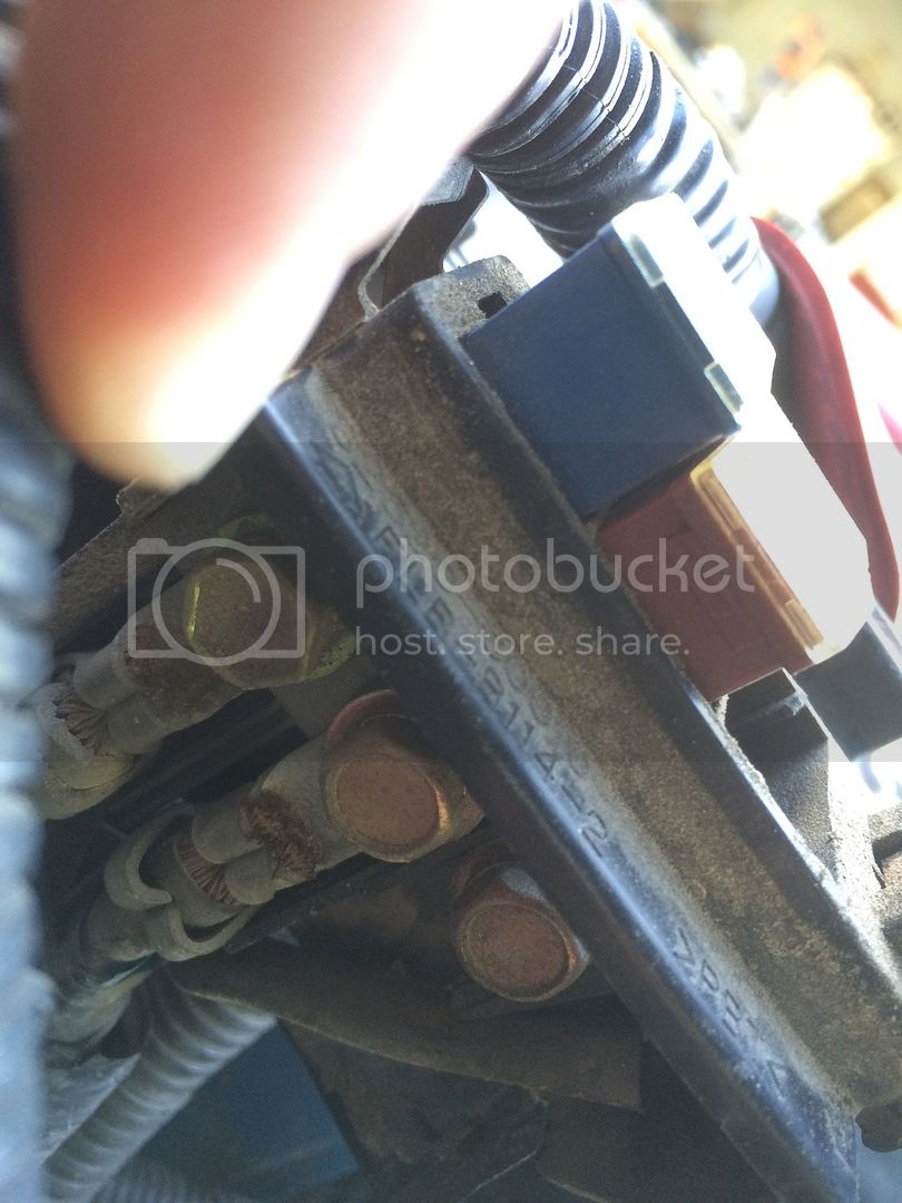

I believe that Toyota already covered this with their system. The 100 series already has this type of system from the factory. The alternator/charge cable is on the left and the alternator sense wire is in this distribution/fuse block.

I already know that it is not ideal to run two different brand, type, or size batteries in the manner I am. Running two of the same is not an option so I want to make the system as good as I can with what I have.
I am thinking that when I run my new alternator 2 awg wire I will connect it to the starter battery post on the Blue Sea ACR. My thought is that this will allow for a more direct feed to the house battery. If power goes the route of least resistance, this method would allow power to go direct to the house battery for charging when the ACR is connecting the two and the starter battery is already topped off. How does this sound?
