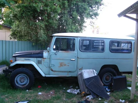

My dilemma is which tub to use... So I'll show some comparison pics of each of these rigs:
"Old Yella", my daily driver:
The green troopy:

So I'm undecided on the following three possibilities, and am appealing to the collective skill, knowledge and experience of you guys, which is ample on this great forum :).
Option A:
Restore the tub on the green troopy, and when it is finished I will transfer it over to the frame of "Old Yella". From there I can pick the rest of the panels from the best I have available.

- Rear sill appears to have been fixed up and appears to be in far better condition than Old yella's
-Does NOT have the extra passenger door, which I believe will be better suited for kitting out as a camper, with a full length bed in the back and long storage drawers.
Disadvantages:
- Bad rust in the footwells and rear wheelwells.
- I am suspect of the PO's rust repairs.
- I will have to swap body mounts to the other frame to accommodate the differences between the modified body (extra door) and the unmodified one.

Best idea would be to fix up the yellow troopy IMO and do it properly, with the tub off the chassis, that is, if finances permit. Hell, that green one actually looks half decent too, sure as hell better than the rustbucket parts troopy I have. I'd love to have the extra door on my '84 HJ 47, since it has the extra forward facing bench seat in the back. Also, the extra door makes the vehicle close to unique and pretty special if you ask me, wouldn't want to lose that.;)

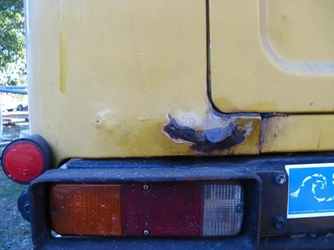

My main concern with the tub of old yella is the rear sill:

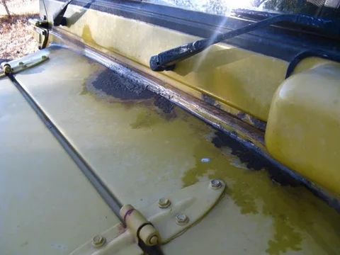

and the cowl:
How hard would repairs be??? I know the sill would need cutting right out and replacing .. but the cowl? under the winscreen surround is looking pretty nasty too.

As Herbs said stick with Yella she more unique even here in OZ with the side door. Cut out the bits you need of the green PC and and remove any other bits and pieces for the rebuilding of old Yella.

Bugger, some nasty rust areas, but, they're saveable, one option would be to get the rear sill and patch panels for the rear quarters from the U.S, there's a bloke on ebay (Realsteelcruiserparts) who seems to have the right gear, but there'd be other options too. As for the windscreen frame, I'd just get another one, there's plenty around. for the cowl, I'm no expert but I'd probably sandblast it first, then see the damage, I reckon it's patchable, though the seam might be a bit of a worry?
