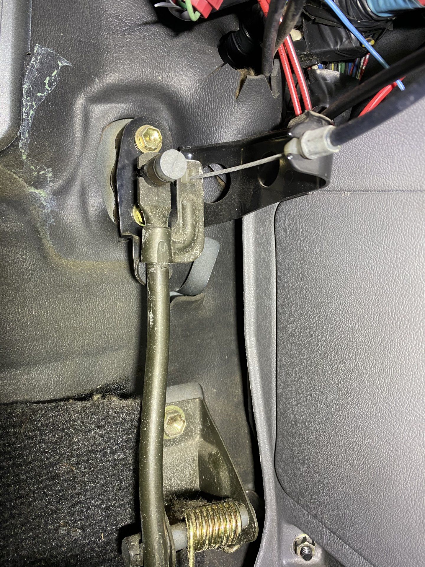

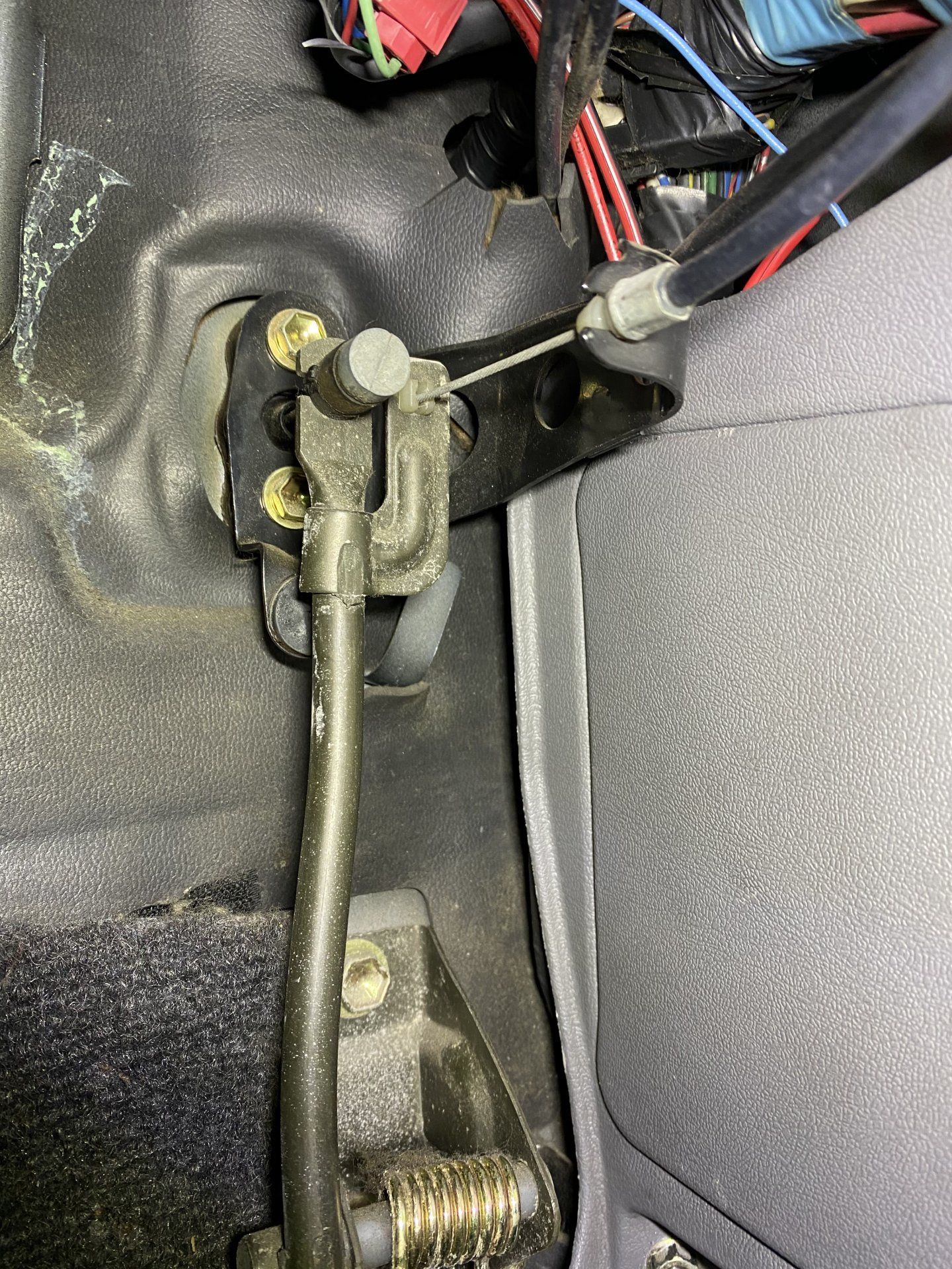

Thanks Cold Taco I fiddled with the knob and it definitely helps but the idle adjustment screw has about a .150 inch gap between it and the idle arm thing (can't remember terminology). I checked the spring under the accelerator and its still strong. AC does not blow cold and compressor is not engaging. Pic of idle position and diaphragm that's connected to the idle up solenoid.
The idle up knob to the right and low of the steering wheel only goes to the accelerator pedal under the dash by the firewall. It pulls back the go fast pedal, so either increasing gas or lessening gas. You have to look at it to see how it works. This knob doesn’t do anything passed the firewall. Don’t know if you already knew that.
Based on your pictures, You should definitely be looking at the spring(s) that will return your throttle back to idle. It should be resting on that screw in your picture above. Your diagnosis can't continue very successfully until you can ensure your throttle is resting in the same spot every time.
If that gap is just there from you turning the throttle adjustment up, then ignore my statement. Just endure that under normal conditions, your throttle link is resting on the idle screw.
Hey guys just want to say thank you for helping me, I'm really new to cruisers and diesel so every bit helps. I checked the throttle linkage and the springs seem to be in order, but it really does not want to return to the idle position. What mechanisms could cause it to stick and not return to idle?
Oh my goodness, you guys just occam's razored the hell out of this. All I needed to do was turn the knob till it was loose and bam, sits flush against the screw now. :D You guys are the best, might need to do some reading so I don't inadvertently cause me issues.
