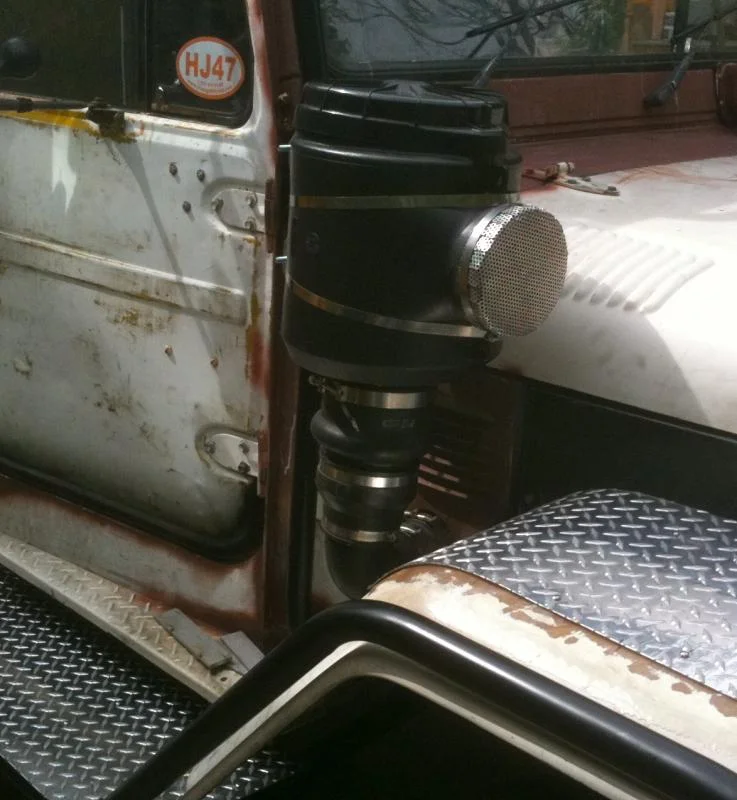

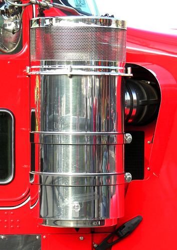

One of these will give you a bit more air. :D
Seriously, I am with Rosco. The OEM Toyota filters are excellent for filtration and air flow. In fact, I was considering swapping one in for my TD42 as the Nissan oval filter just barely provides enough air and it is fairly common for Patrol owners in some parts to swap in the Toyota assembly from a 12HT or 1HDT.
The only way you are going to get more air flow is by going with a filter assembly which uses a bigger filter cartridge - hence increased filter media area. So, I guess you could strap in or on a larger Donaldson (or similar) set-up and get more air flow. My question is have you seen any data proving that the current filtration set-up is not providing sufficient air flow.
