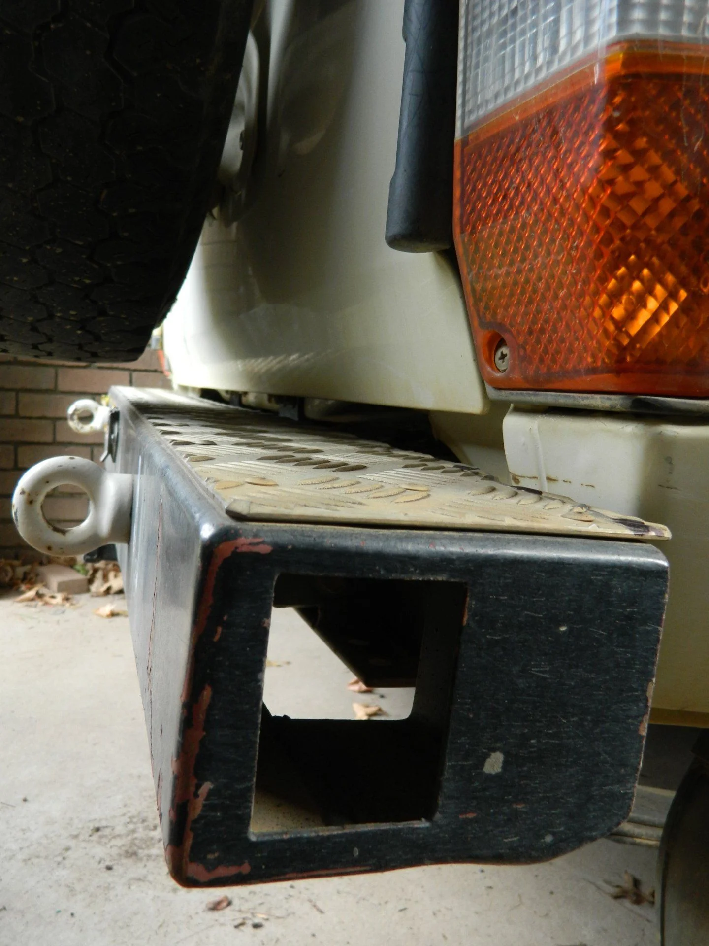

A couple of years after I purchased my BJ73 (1990, so lets say in 1993 ish), I made up a replacement rear bumper bar for it.
At the time, I incorporated rectangular holes in both outer ends of this bumper, to accept the tongue of a Hi-Lift Jack (HLJ). Since then (two or three ish years ago), I seen that several commercial "Hopper-Stopper" (Roo Bar/Bull Bar) manufacturers, have started to incorporate "Tee-Slots" in their bars.
So, in anticipation of getting my rear bumper powder coated some time soon, I got to thinking......
Here's some images, of what came out of this thinking.
The end of the original replacement bumper, and the HLJ lifting hole

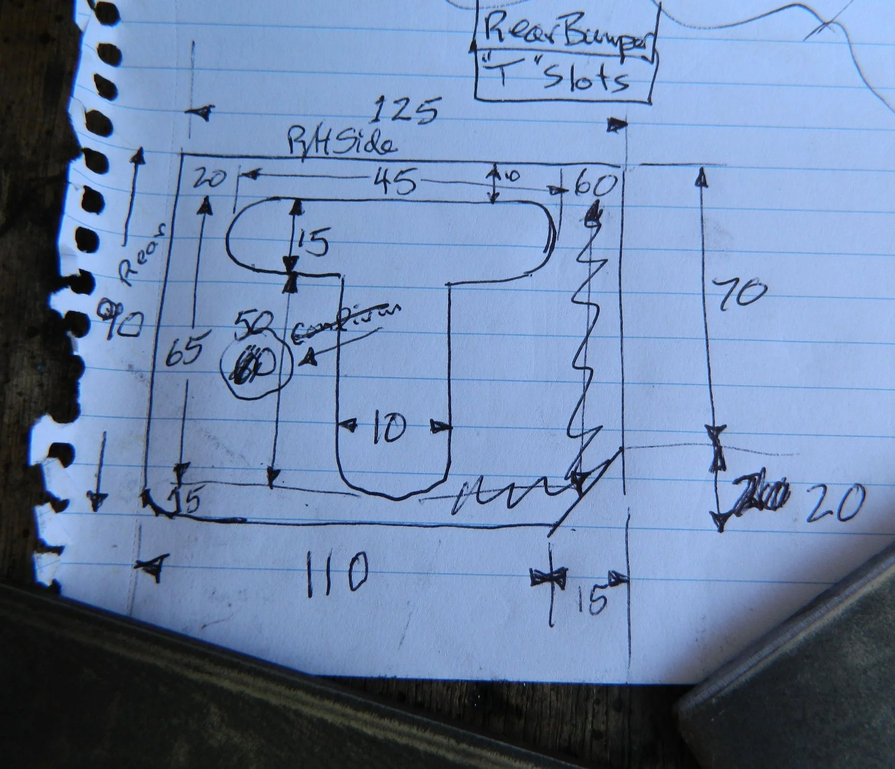

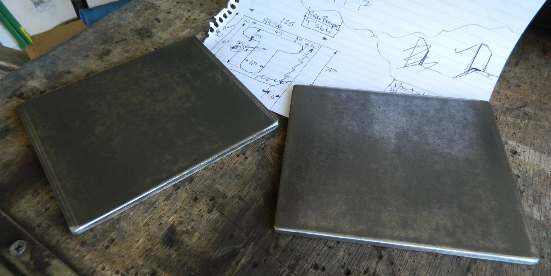

The 5mm thick end plates and the drawing of the Tee-Slot dimensions (please note, that it is now 15mm at the top space and 10mm at the bottom).

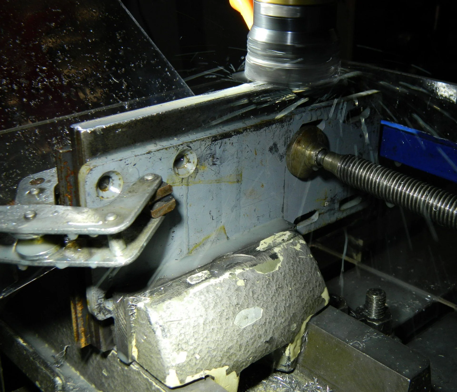

Machining the new, replacement end plates to size.

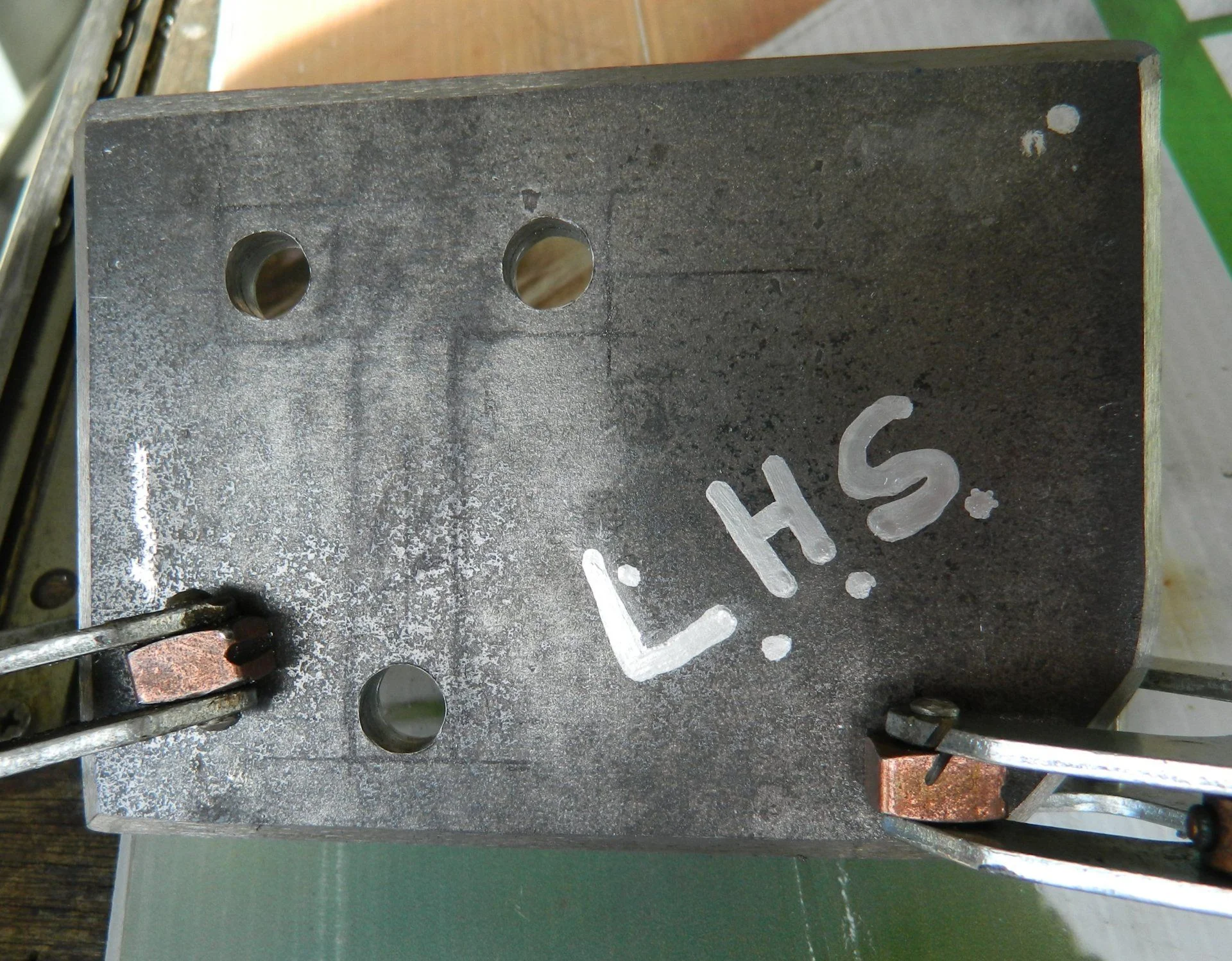

Marking out and drilling 10mm Dia extremity holes

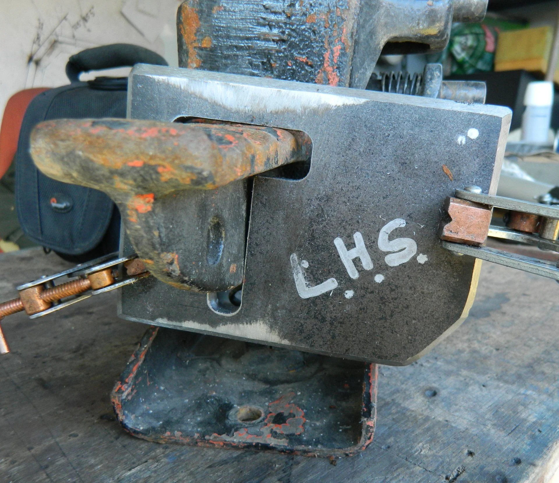

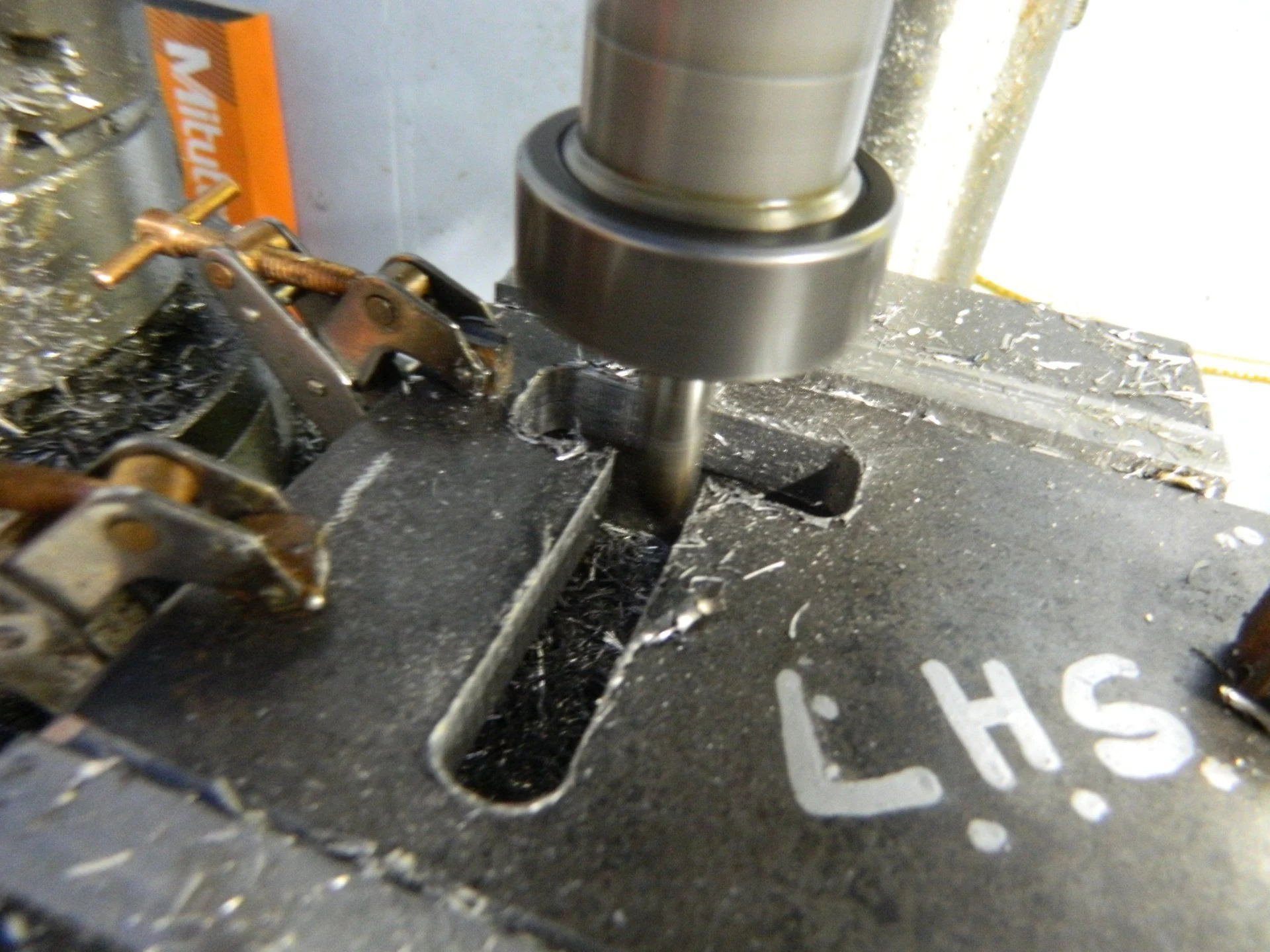

Here you can see the new replacement end plates, having the Tee-Slots machined in them.
The newly machined Tee-Slotted end plates, in place on the tongue of the HLJ.
Some time in the near future, I will remove the rear bumper, and use the "Hot Glue Gun", to stick these new end plates to it (prior to powder coating the whole thing).
