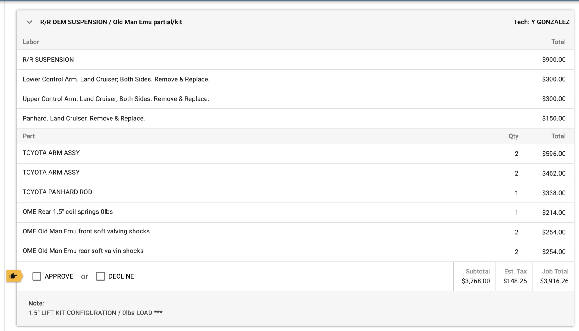

Option 1: Old man emu 1.5 soft Spring with stock Toyota control arms and stock torsion bars. - Installation cost $3900.

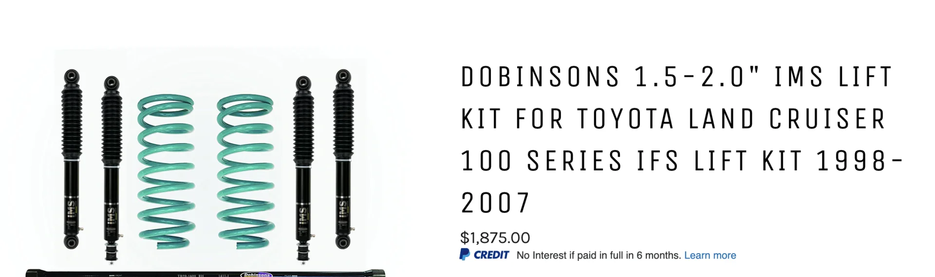

Option 2: DOBINSONS 1.5-2.0" IMS Sharks with Toyota control arms and Toyota torsion bars. - installation cost $4900.
