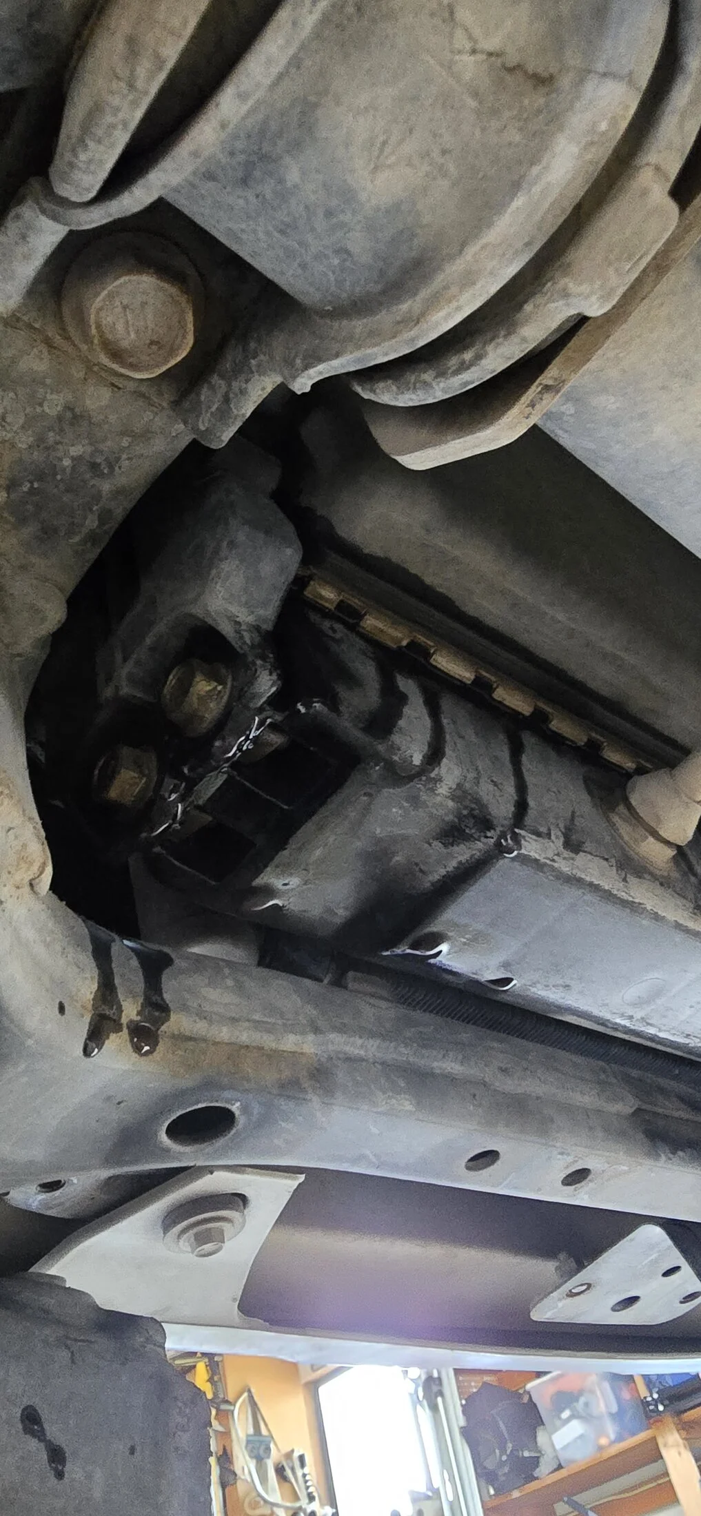

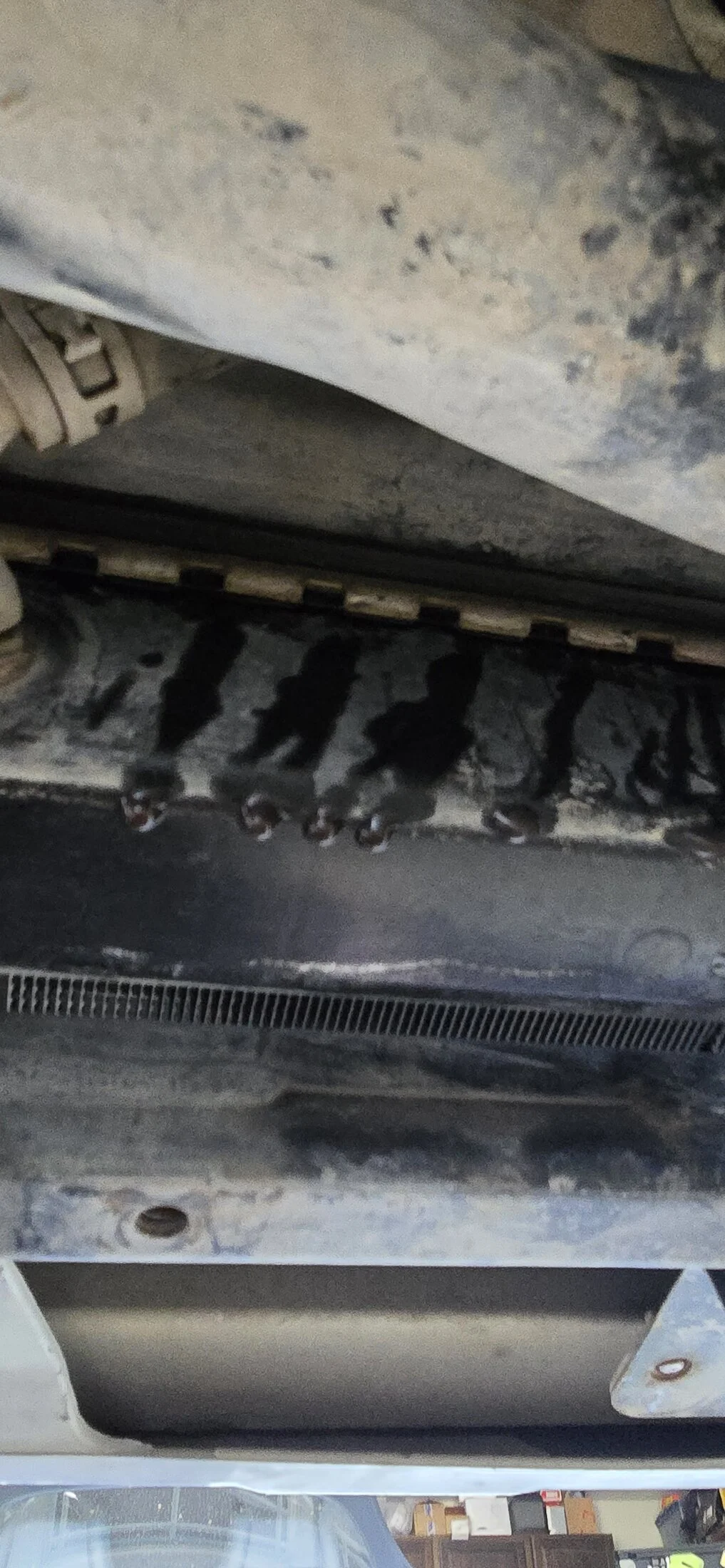

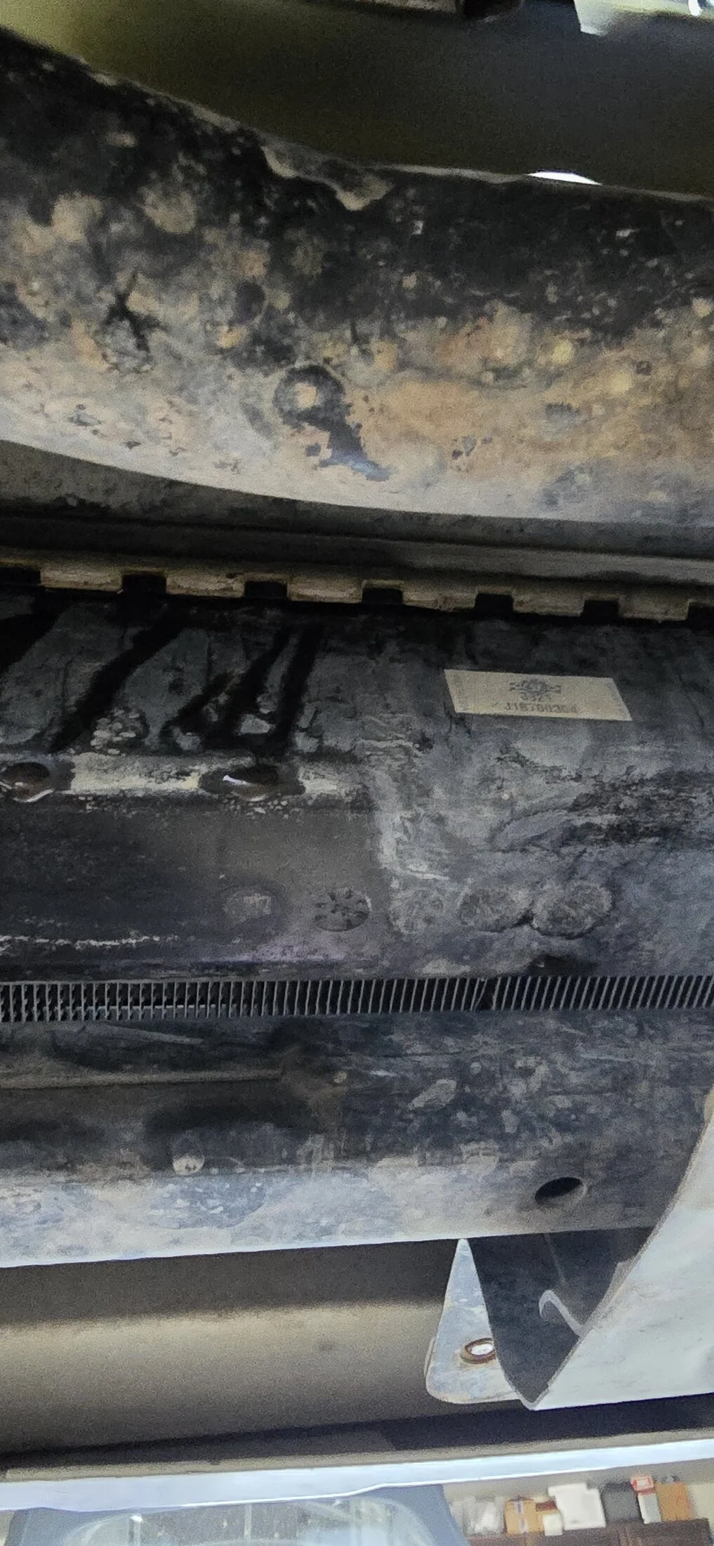

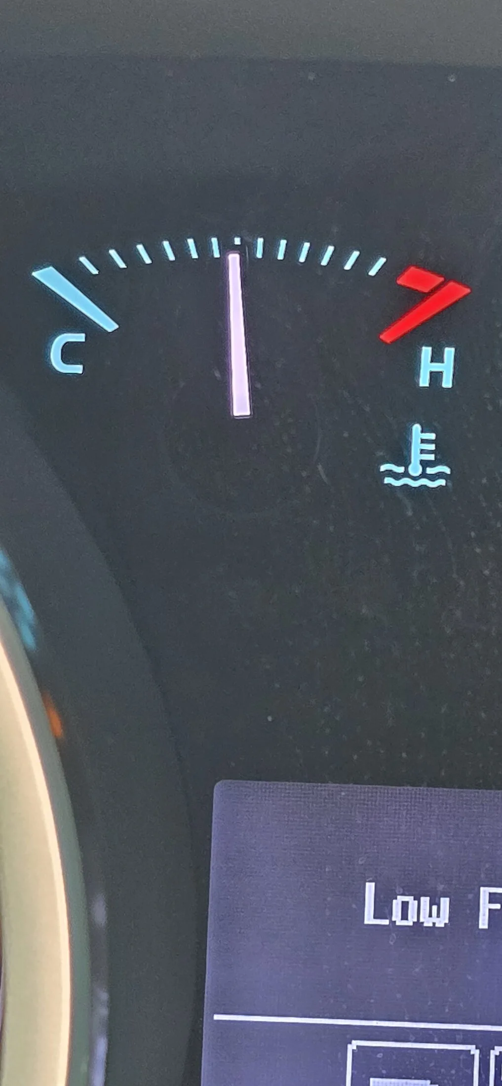

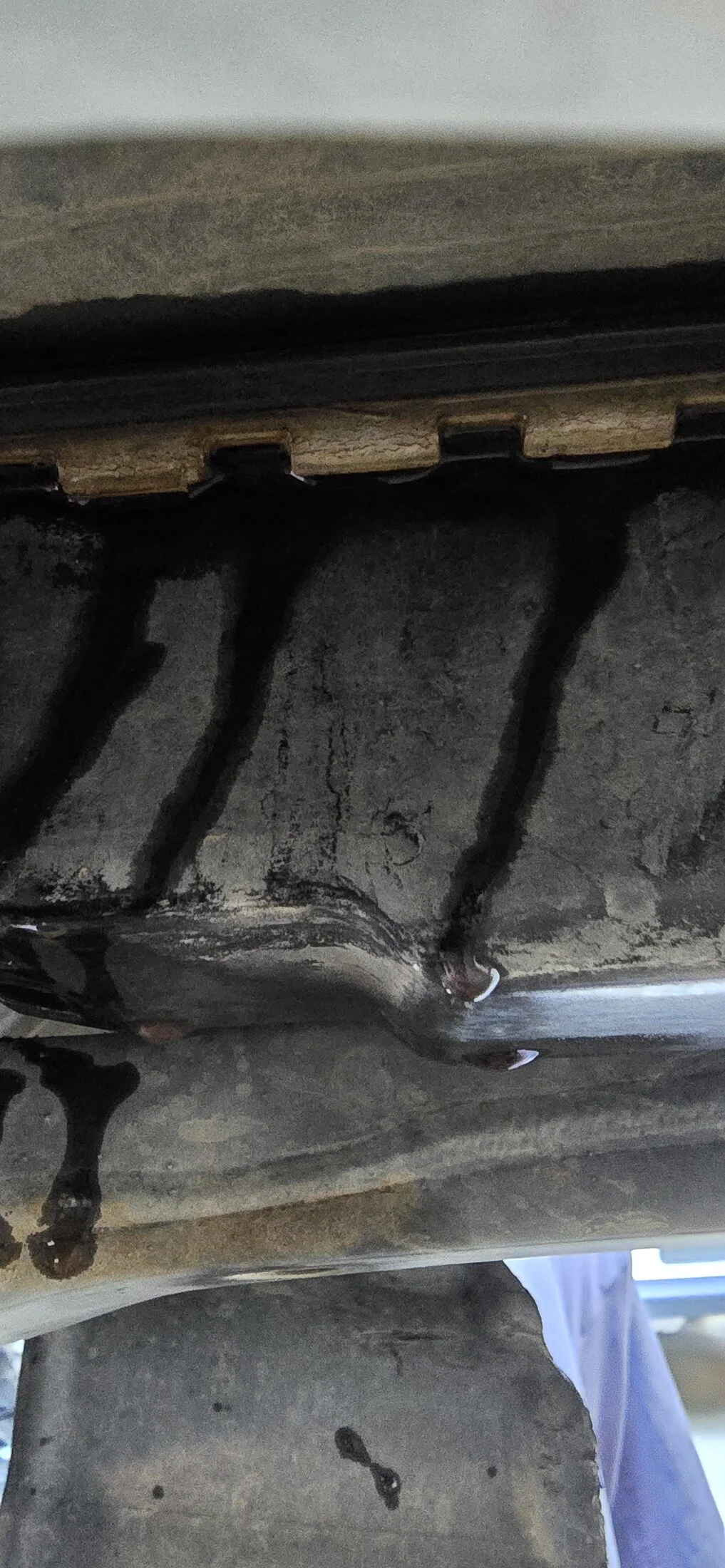

I have a 2011 200 series with 175000 miles and tesreday after returning from taking my dogs to the river I noticed a good amount of coolant leaking on to the ground in my driveway. I took the skid plates off to get a better look. It appears that the coolant is coming from the bottom drivers side of the radiator. I topped off the overflow and started the truck to let it warm up. The temp guage came up but the heater was blowing cold? Anybody have ideas of what this might be? Cracked radiator? Bad thermostat? All of the above? I need to take my daughter to college this weekend. Any help would be appreciated.

looks like water condensate to me not the pink antifreeze
There is no thermostat at that location. The drip is from the radiator itself. Time to get a new one.
If this is the original radiator you should have replaced it anyway due to the crack at the top. If you have not removed the engine covers yet to take a look, do that as it might actually be the crack at the top.
Yes, I have parked it. I examined the top of the radiator closely and there are no cracks or fluid. It all seems to be coming from the bottom drivers side. I am still confused as to why no heat is coming out when it is up to temp?
Could be an air bubble in the heater core if the level got too low. Probably needs to be burped after the leak is fixed (or will happen if the rad is replaced”
Being low on coolant can cause odd issues with the HVAC. How low was the expansion tank?
