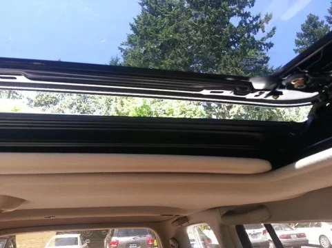

Did you ever figure this out? The same thing just happened to me. I was sliding the sunroof closed and this piece fell out.
This happened with mine - couldn't figure it out for the longest time. Finally figured it out.
If you open your sunroof and look toward the rear of the vehicle, you'll see a thin black piece of metal. On the top side is a channel - that is where the "arrow head" goes (push it in). The flap then slips over the front edge.
Open slide or open tilt?
