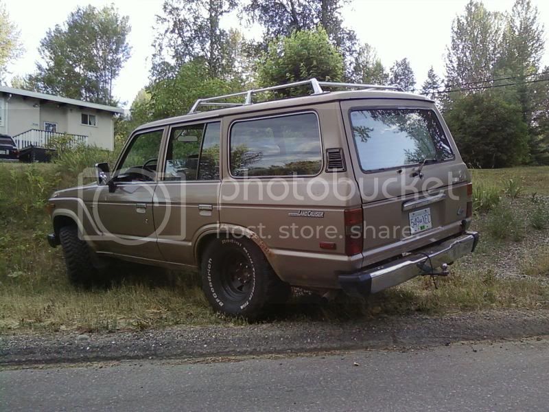

I'm driving an 88, all stock, and put 33x10.50's and havn't had a problem with any rubbing yet. I've even done a fair amount of off-roading with a decent amount of articulation, and no issues. With the old springs there's not going to be a whole lot of articulation going on anyway. Go for it and enjoy the extra 2" of lift!
Also, I have pictures on here somewhere. I'll post the link when I find it.
33x 12.5 x 15 on my 86 hj60
only rubs in the rear and just barely on the crappy metal patch job that somone was too lazy to cut off 1/4" in the wheel well. Front has little to no flex with the diesel over load springs in it so rubbing hasnt been an issue. It might have had some rub up front with the super loose wheel bearings and trunion bears that it had when i bought it tho.
thx shance for posting your pics.
