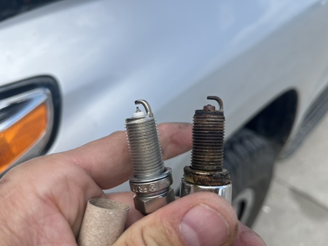

UPDATE: I wanted to add this to the dialog for future searchers/reference. I didn’t replace the plug the first time because the coil resolved the symptoms. About 1000 miles later the replacement coil died. This time I pulled the plug and it was wasted. I had already planned a fresh set of plugs when I got home, but that’s definitely on the top of the list now. I haven’t changed them myself, so I should have done them already, but it’s possible they’re original… That was the next thing on my baselining list.
So, moral of the story is, check your plugs if you replace coils.
Wowzahs, those plugs are toast. It might not be a bad idea for all of us carry a spare coil just in case.
Yeah, those are brutal man. Good to see you got to where you needed to be, and thanks for reporting back as some forget the update part of their threads. That always helps mudders in the future.
I think the long life of spark plugs these days makes us (me anyways) take them for granted and forget them. I’m home, and the new plugs are due before the weekend. Hopefully I’ll get the time to swap them. I’m very curious if they’re all this bad. If so it’s safe to assume they have 261k (now) miles on them 😳
