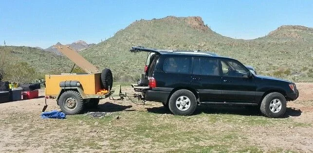

Agreed. A cheap M101 A2/A3 can be had for $600 or less, you'll have all of the storage room you need. I have 4 kids and went the Expo trailer build route. I paid $600 for this trailer.
