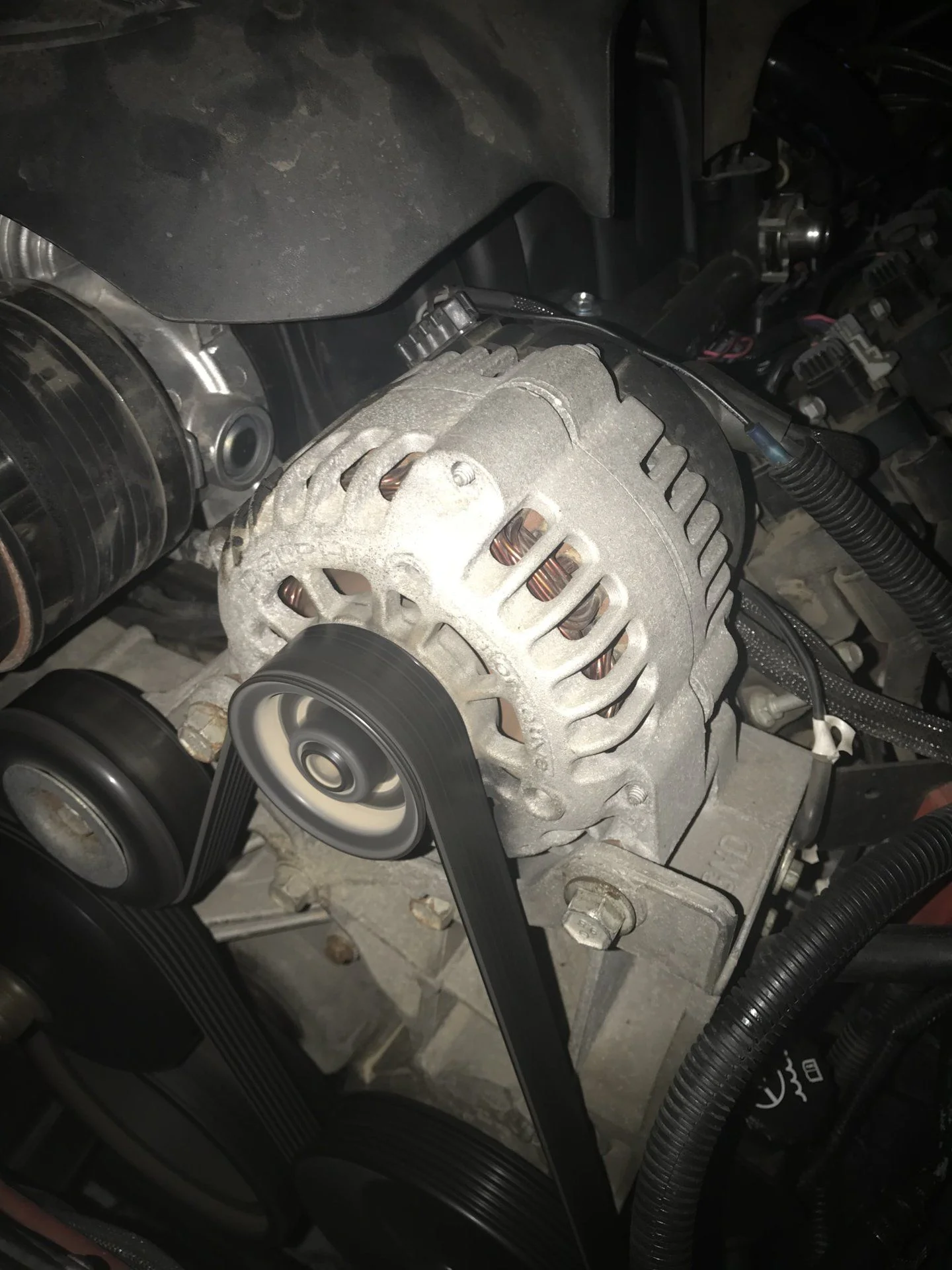

Having a moment of weakness here so I need an hand.
My Vortec needs a new serpentine belt, so that’s the easy part.
The hard part is I’m not sure which one to buy? In the past the alternator was changed out so I don’t know if it’s 105 or 145....it’s a Delphi Unit without any part numbers.
I’m trying to find the correct length belt that’ll fit the system, specifically a continental elite, and summit racing lists (3) different belts with variances in length. Some are made to fit the 105 amp and some are made to fit the 145? If there’s any difference
Am I missing an easy way to do this?

I’m guessing the AC Delco part # 923 is in regards to length. Both summit and amazon both show this part number for the 03’ vortec
And this is supposed to fit the 105 amp alt

If it’s chirping, you may need a new idler and/or tensioner pulley(s).
My AC idler seized a while back, so I replaced all of them while I was in there and kept the main tensioner & belt as a spare.
I was thinking the same, the only reason I didn’t order them is because the belt is so old . Hoping it’s just because it’s long overdue and the sub zero temps every day haven’t helped. The chirp is only when I first turn the truck on, after I drive it for a time it goes away
