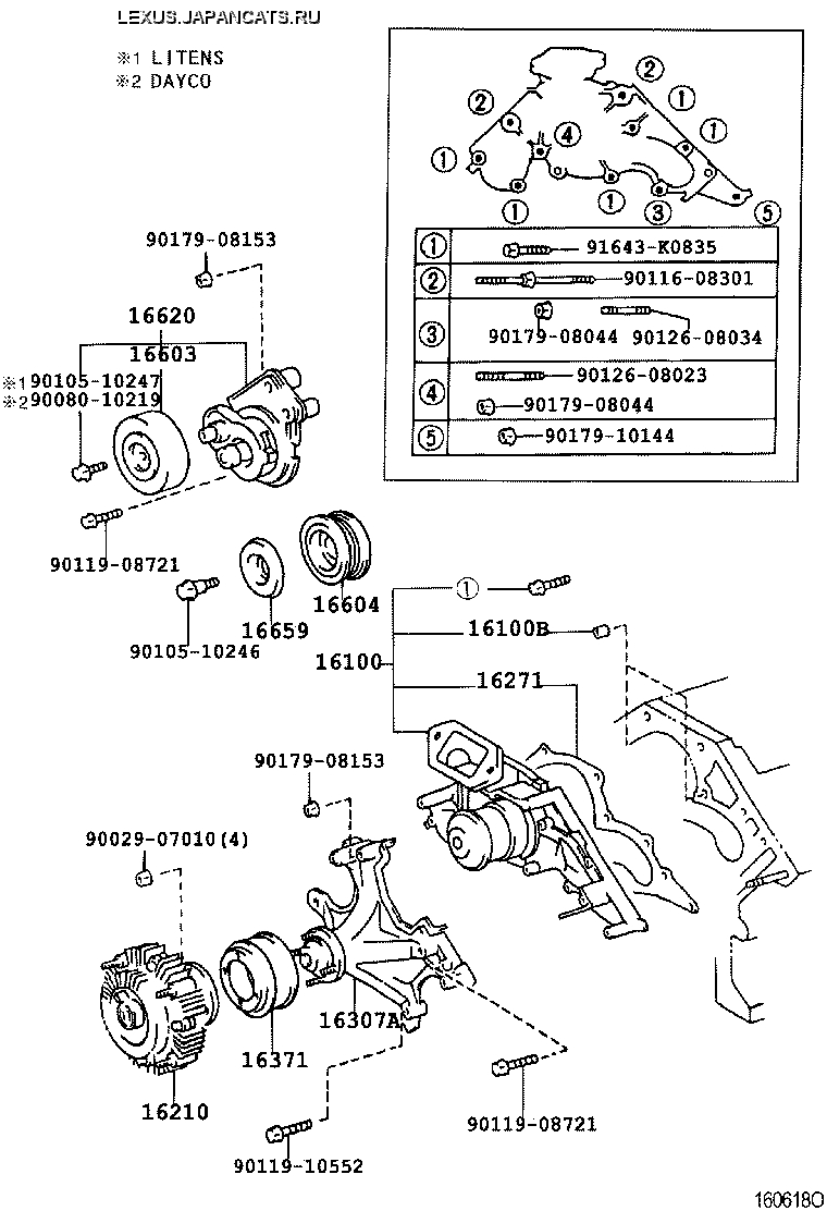

Hi forgive me for never introducing myself... But I believe I know what that noise is and unfortunately what will happen if left unattended... Last January I purchased my very first LC and after about two months I noticed a sound very similar to that in the YouTube video... One morning on my way to work I noticed the sound it was really really cold outside so I thought that maybe the belt was just stiff and chirping a little bit but on the ride home the weather was significantly warmer and the sound still persisted I only noticed it when I was at low RPM's (idle-1800) and once I got about 2 miles away from home the bearing on the pulley completely gave out and caused a extreme amount of play resulting in the serpentine belt coming off... Causing the loss power steering and I believe alternator... Once that happened it was very obvious what part had malfunctioned and this is the part. 1607A
1607A
image3.asp@piid=40594&treg=E
1607A
