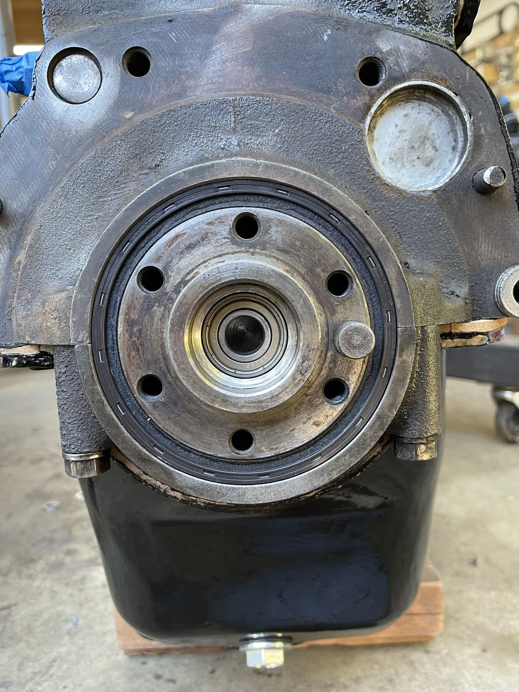

Anyway the transmission is coming down so I can see the seal better. This is how it was when I put it in:
