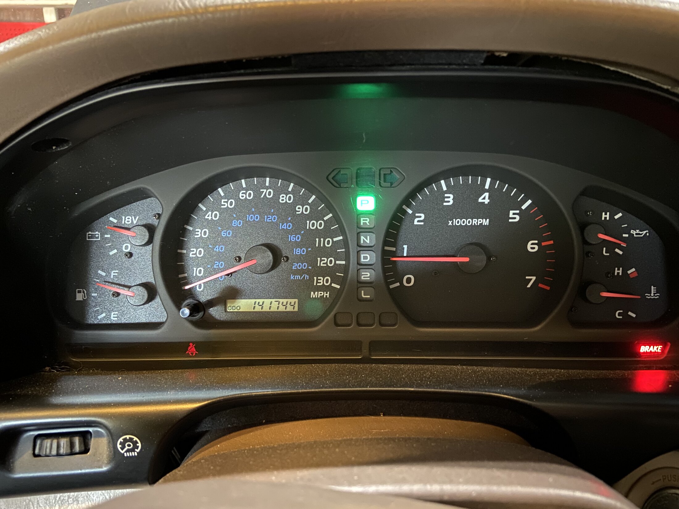

Nearly fully warmed up after 10 min of idle, no noises like in the first video. Gauges look normal.
