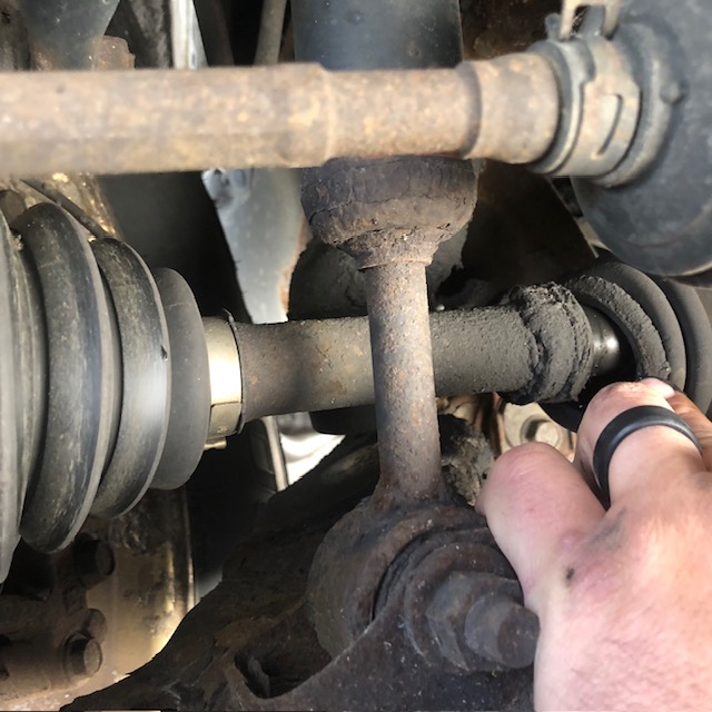

Issue #1: CV axles - the inner boots have lost their clamp to the shaft and have thrown their grease everywhere underneath, and I'm not sure how long they've been that way - could have been 50K miles for all I know, or it could have been 20. Symptoms - NOTHING - rides smooth. Question - can I clean everything up really well, add new grease and put a new clamp on and hope for the best? Or is it an imminent thing that needs to be done? And of course, as always, Toyota CV axles are probably the only option - no aftermarket.

Your CV boots are torn so those can’t just be rebanded. I wouldn’t try to regrease and clamp those because the existing grease will be contaminated and the clamping surface of the boot is torn off. They can be rebooted with a kit from Toyota that includes new grease.

If you don't want to re-boot the CV axles yourself, I'd get a set of reman axles - either from Toyota directly or from NAPA (Toyota axles will have the better boots than a NAPA reman axle). Don't get a "new" axle unless it's from Toyota, anything else will be a Chinese knockoff axle. The CVs aren't hard to DIY if you have the tools, an they won't be expensive for a shop to change out either.

Thanks, Toyoland - appreciate the insight here. That all makes sense, and I'll have my guy look into those fixes. I forgot how much fun it is to baseline an old 4WD SUV that has over 200k miles.
