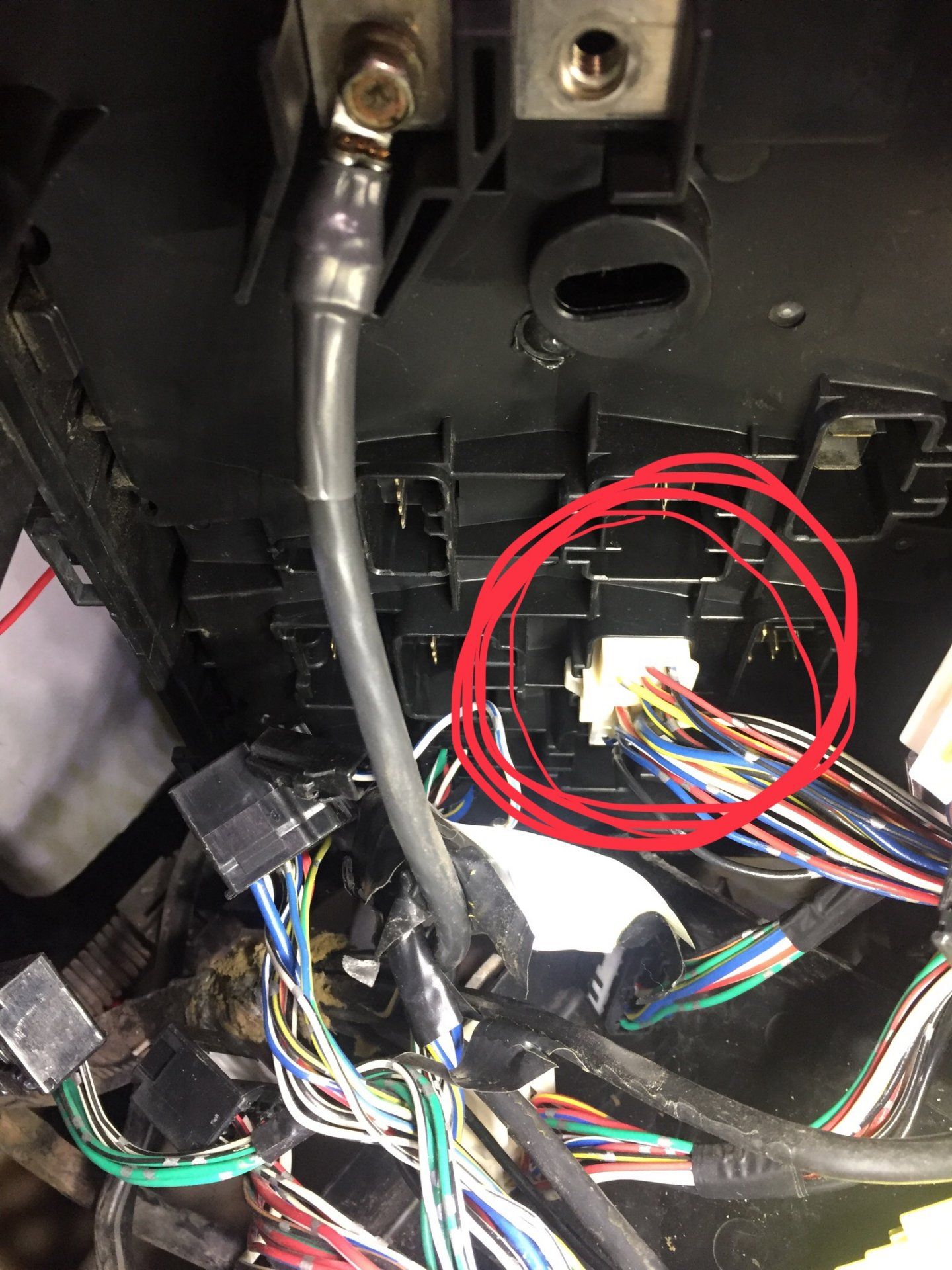

I’ve got a .5a draw on this truck, unplugged all under hood fuse block connectors and found this one as the source. If i unplug that white connector the draw is gone.
I have pulled all fuses and relays in that fuse box and there is no change.
I have disconnected just about everything under the dash, unplugged both footwell fuse boxes completely. Still there.😩
I cant find anywhere in the repair manual that says what is powered off that connector.

Easiest way is to get an amp meter and start pulling fuses until you see a drop. Then figure out what that fuse goes to.
Did you just unplug it and search for what wasn't working? Luckily it's non-essential. I'm getting a ~.2 draw from my truck and the battery keeps dying if I leave it sitting for more than 3 or so days. Need to track it down.
I basically had everything under the dash unplugged, and the rear a/c stuff unplugged, I was really stumped. So then I just started working down the center console and when I unplugged the changer the draw disappeared. I've heard of changers doing this and I even thought I should check it but I didn't until I had basically everything in the whole damn truck unplugged and still had a draw.
It's a PITA, hopefully you can find it by pulling fuses/relays. somehow with all the fuses and relays pulled the draw persisted and I had to just start unplugging s***.

start pulling fuses and look for the draw to go away, then you know what components to check from there. Do you have a cd changer? If so maybe just unplug it and see if that does it since it seems to be a thing. I'm assuming you have a multimeter/dvom and know how to use it, if not then you have to buy one and watch a couple youtube videos.
