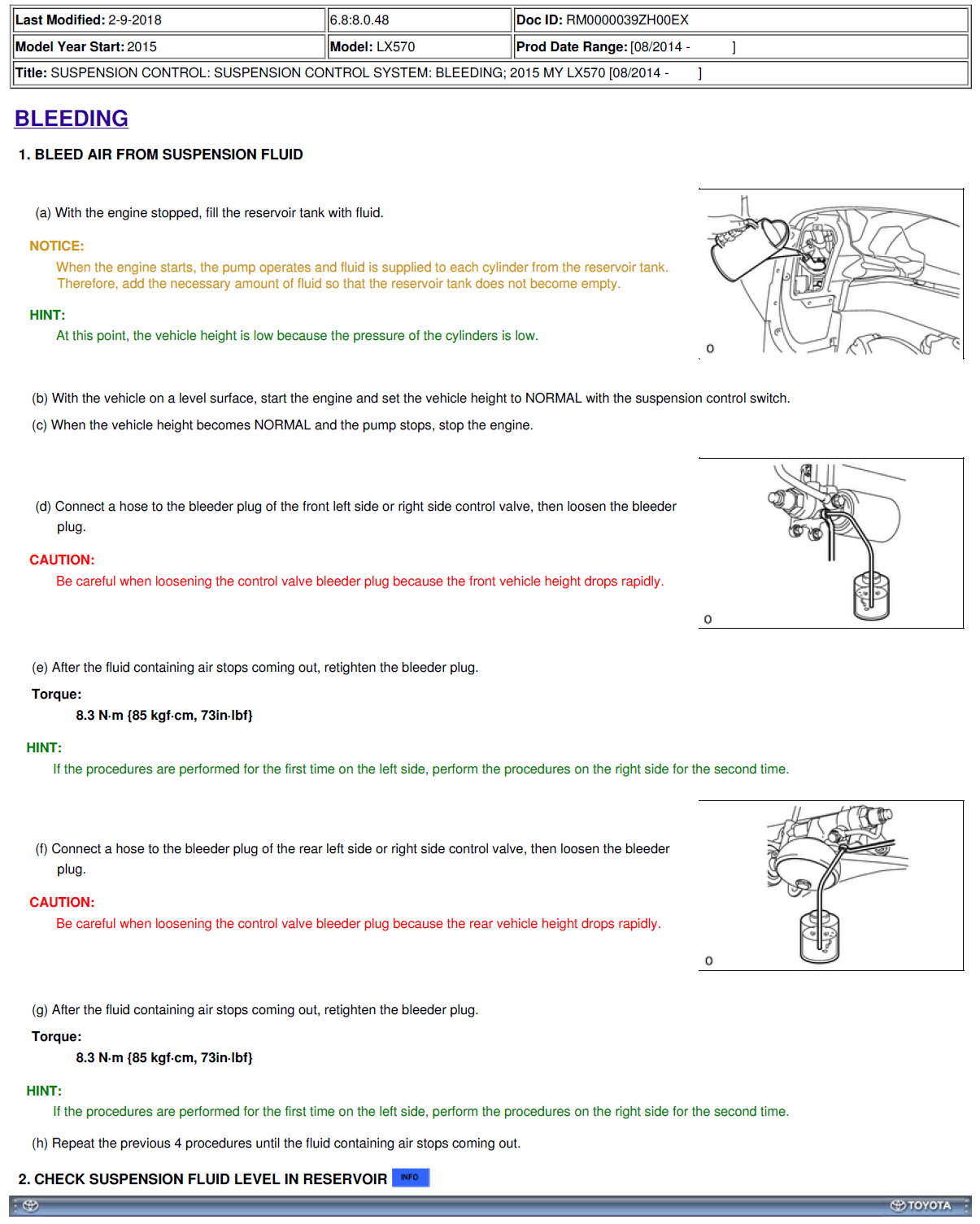

Today I’ve attempted to change the fluid in my 2011 LX. I pumped out the old fluid in the tank per the pdf I downloaded on here, and refilled to above the max line. While draining the first bleed point, I Inadvertently removed about 12oz of fluid from the first Bleed point (rh front). I then started the vehicle and attempted to raise to N. After about 30 seconds of hearing the pump run but no actual adjustment in vehicle height, it gave me a check 4 Wheel AHC error. Simply starting the truck and letting it run for a minute or two gives this error now. I do not have a tech stream and honestly have no idea how to proceed. Can anyone help me out?

Try disconnecting the battery for 15 min and try again. Probably getting an abnormal oil pressure in the motor code. Drain another corner (a bit) and see if that gets it moving too

did you bleed in N mode or Lo? Does it look like the rig is currently in Low or is your right front dropped?
You should raise to N after topping off the reservoir. bleed a corner, start the rig (dont raise to Hi), then shut off and continue bleeding.

Truck is currently stuck in low. I’m going to wait for my techstream cable to arrive before investigating further. I’ve disabled ahc, it still throws a check ahc error when driving. The rear has been extremely slow to adjust since I bought it, which I was hoping was just an old fluid issue. One thing I noted when I bled it, the passenger rear had so much air in it that it looked like foam. Still trying to find the procedure to remove air from the system, which I’ve seen referenced, but can’t find
I have it posted above. Are you looking for something else?
At this point, I would start over with the 5th accumulator, the driver front, pass front, then driver rear, pass rear. Then, use Techstream to erase the codes if you still have issues.
No, that’s the correct procedure, I was having a senior moment when I looked at it.

I’ve re bled the corners and got no air. I haven’t been able to get the cover off to bleed the accumulator. Nothing happens when I perform the individual wheelup/down tests. When I do Front or rear up/down by accumulator, the pump runs. The back does not change, but the front test does raise slightly. The pump makes a high pitch noise in all events, which I am interpreting as a pump running without fluid in it. At this point, all I can think of is there is some sort of clog between the tank and the pump. Does anyone else have any ideas before I start pulling off the rear bumper cover?
