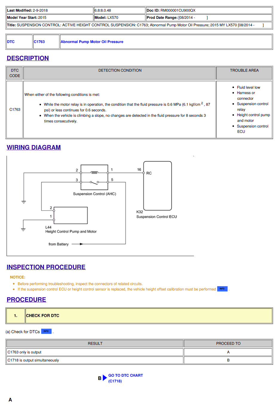

You've got this... see if any of this helps you (i have more confidence in what you've done so far vs a mechanic that has never see ahc before)
These images are from the C1763 error section (first page above). Not sure if relevant since you're hearing the pump run

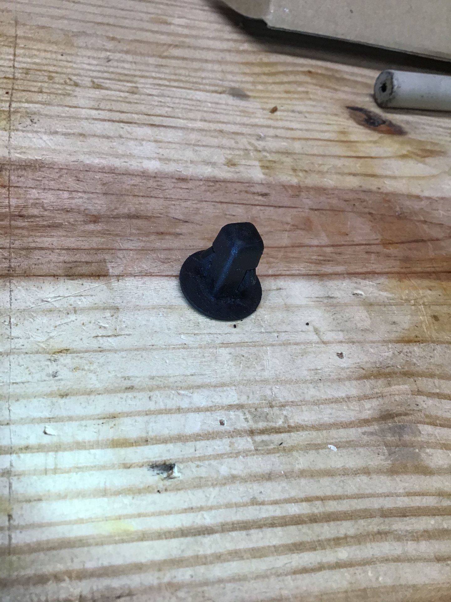

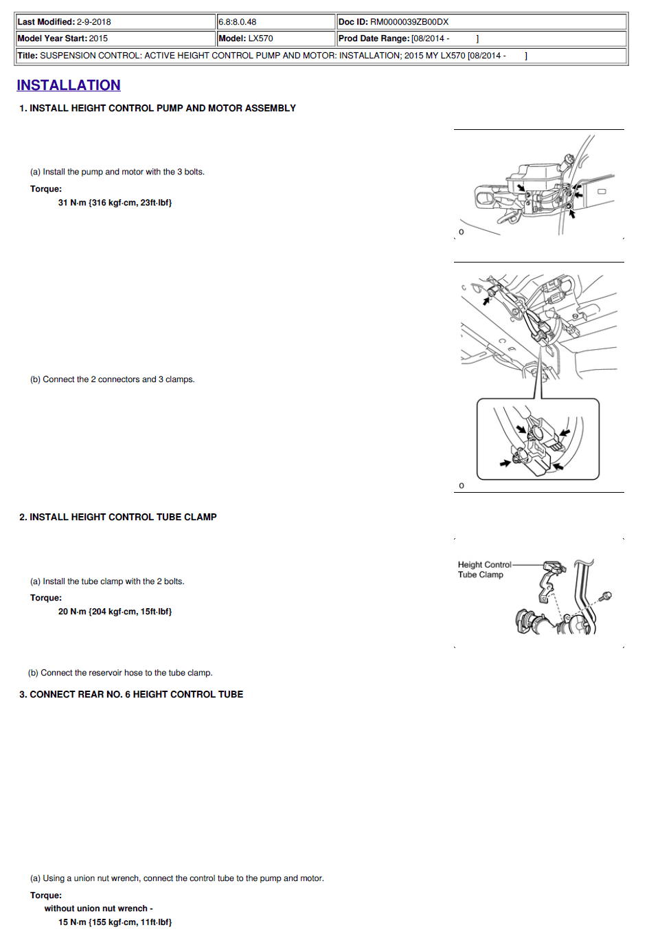

the manual shows removing both rear mud flaps, and the bumper cover. All easy, but don’t forget to unplug the rear sensors from the bumper. You also have to remove the luggage compartment cover protector 1 and the Fuel tank filler pipe protector. These were easy except for the 6 square plugs, which I had to cut to remove. I ordered a bag of replacements on amazon that should arrive today. 4 on the fuel cover, 2 on the luggage. I was able to get the luggage ones out.
You will need to discharge the fluid from the 5th accumulator to depressurization the system.
It all sounds more complicated than it is. Other than an hour wasted fighting the square plugs, it took less than an hour to remove all the pieces.
the annoying plugs in question:
