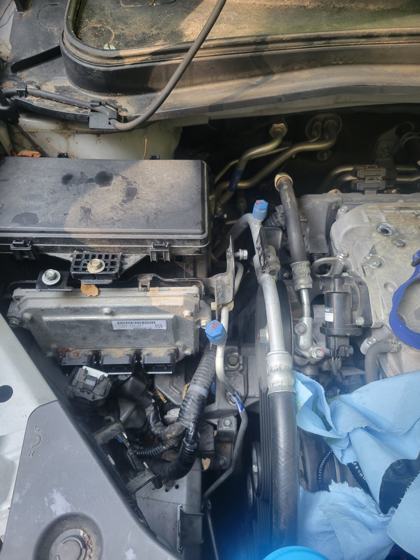

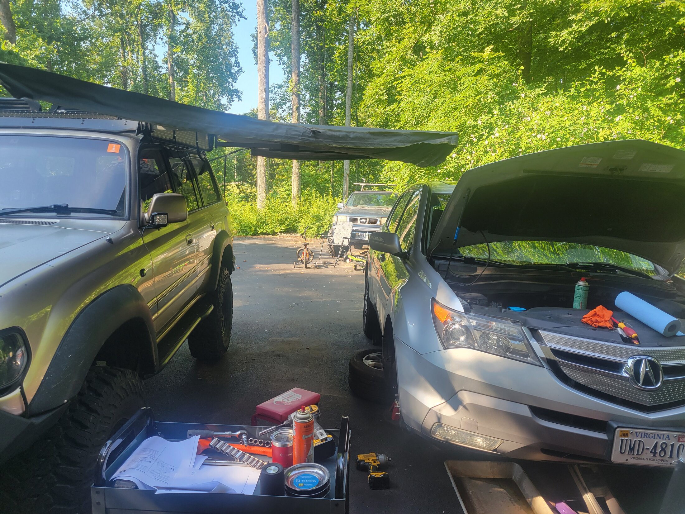

Pumba providing some much needed shade on my wife's Acura MDX. Timing belt, waterpump, oil pump replacement. If anyone needs/wants to see the process on a v6 honda I'm working on it today, Saturday and Sunday.
I have one if you need it in the future
I highly recommend NOT doing the oil pump, waterpump, timing belt, thermostat on a 2008 acura mdx. I saved $1500 in labor but damn it's definitely a knuckle buster of a job to do in a driveway. Working on the landcruiser is much easier!
Just think of it as $1500 able to go into the LC and all the pain goes away. 😆
