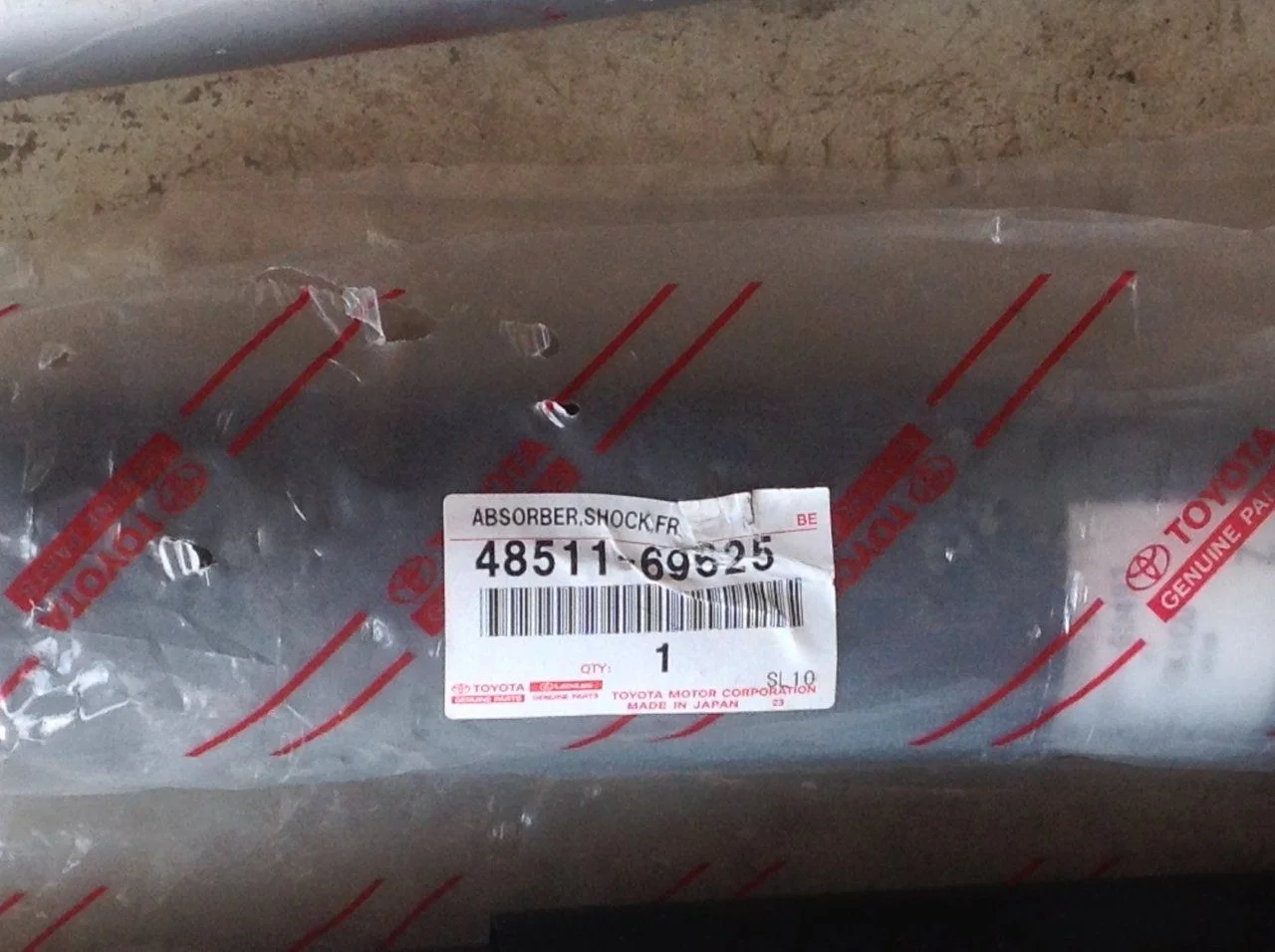

image.webp image.webp I bought 4 Toyota shocks at the dealer yesterday for a 1988 FJ62
Toyota Part # 48511-69625-front set
Toyota Part # 48531-69835 Rear
$50 each all 4 Toyota shocks for $200

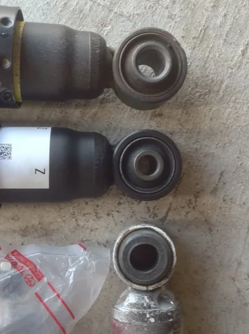

I tried to get the fromts on today but the lower shock eyelet of the new shocks are too small for the shock To go on. In the photo the 3 shocks are top FJ Cruiser shock, middle- 48511-69625, bottom is the shock I removed. Middle part which is what they sold me for the 88 FJ 62 is smaller in inner diameter than the other 2.
I tried the front shocks for my 2012 Toyota FJ Cruiser laying on the shelf thinking of the fastest option to drive it now and low and behold, it fit. I still need the mounting hardware but am needing help deciding what part should I have originally bought for the front of the 1988 FJ62? & If this is correct part #'s why wont it fit?

That's the wrong shock. That fits the 100 series cruiser.
You want PN: 48511-69096
Qty 2
