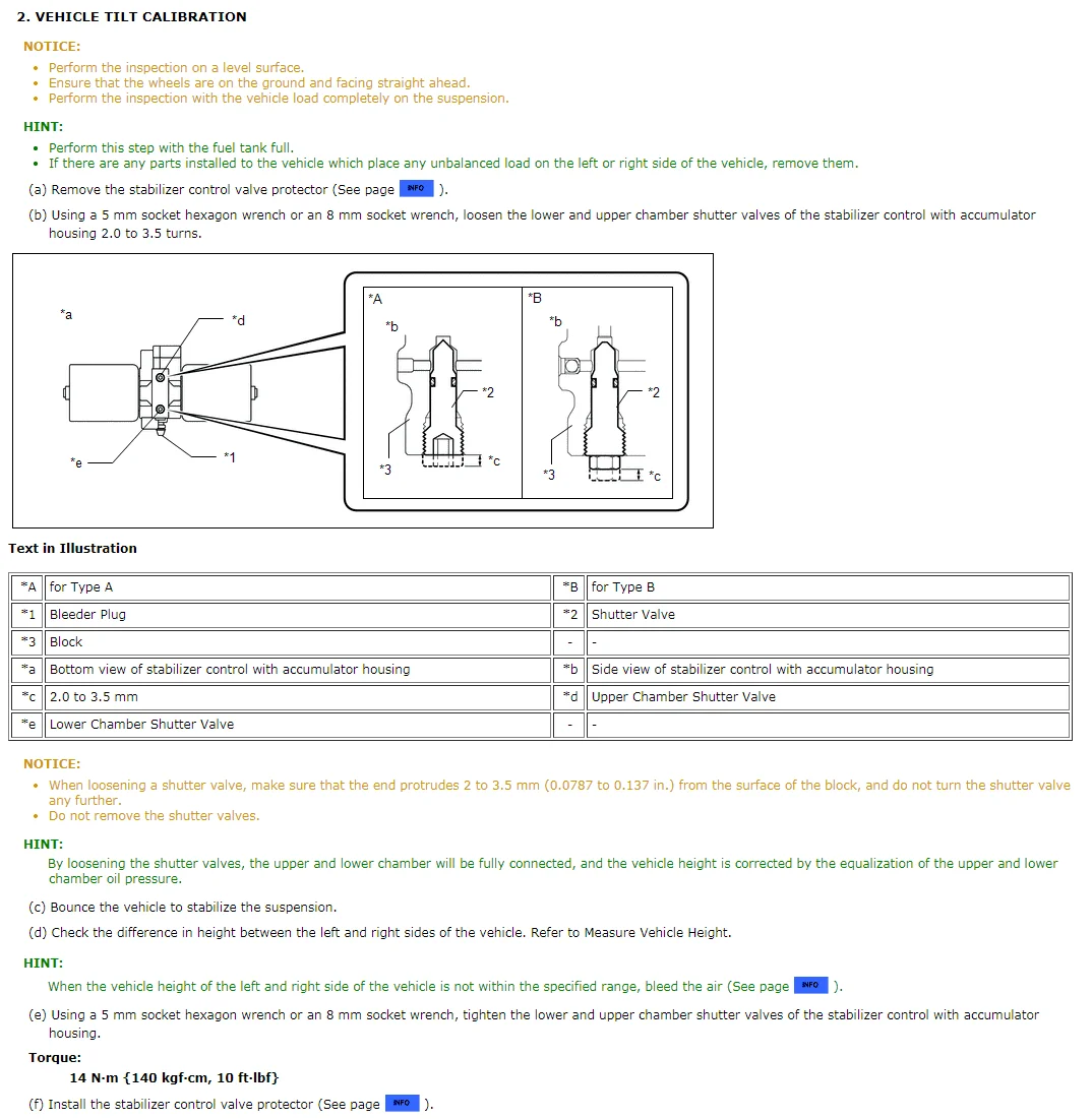

It is super easy if you have a set of metric allen wrenches. Yes you don't want to open it more than 3 turns, but all you need to do is line your allen wrench up parallel to the frame and then count the number of turns. You can probably stop at 2.5... I've done 3 turns but somewhere around turn 1.5-2 the KDSS opens up (you can't tell unless you have the vehicle on a lift, and then when you turn it the suspension will quickly and obviously droop). To make opening the KDSS easier I use a cheater - a 10-12" piece of 1/4" copper pipe I slide over the allen wrench handle, which gives extra leverage and makes it super easy to turn the valve.

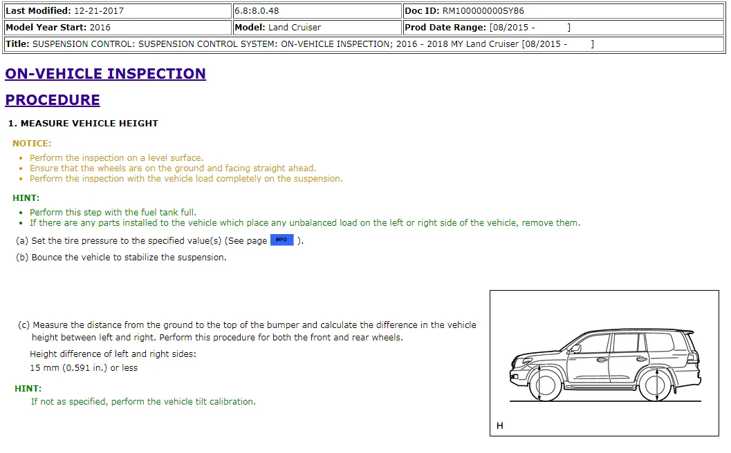

Proper way to measure is fill the vehicle with half a tank of fuel, park it, turn the KDSS screws 2.5-3 turns, let the vehicle sit about 20 minutes, bounce it at all corners, tighten the KDSS screws back up, and then measure. Toyota says left-to-right should be within 15mm (5/8") for factory setup. If it's more you're supposed to take it to a Toyota dealer and have them bleed and repressurize the system using their special tool.

Dan here's the official Toyota FSM pages for your 2016 for KDSS leveling. Note that you don't need to remove the cover over the KDSS (step 2a).

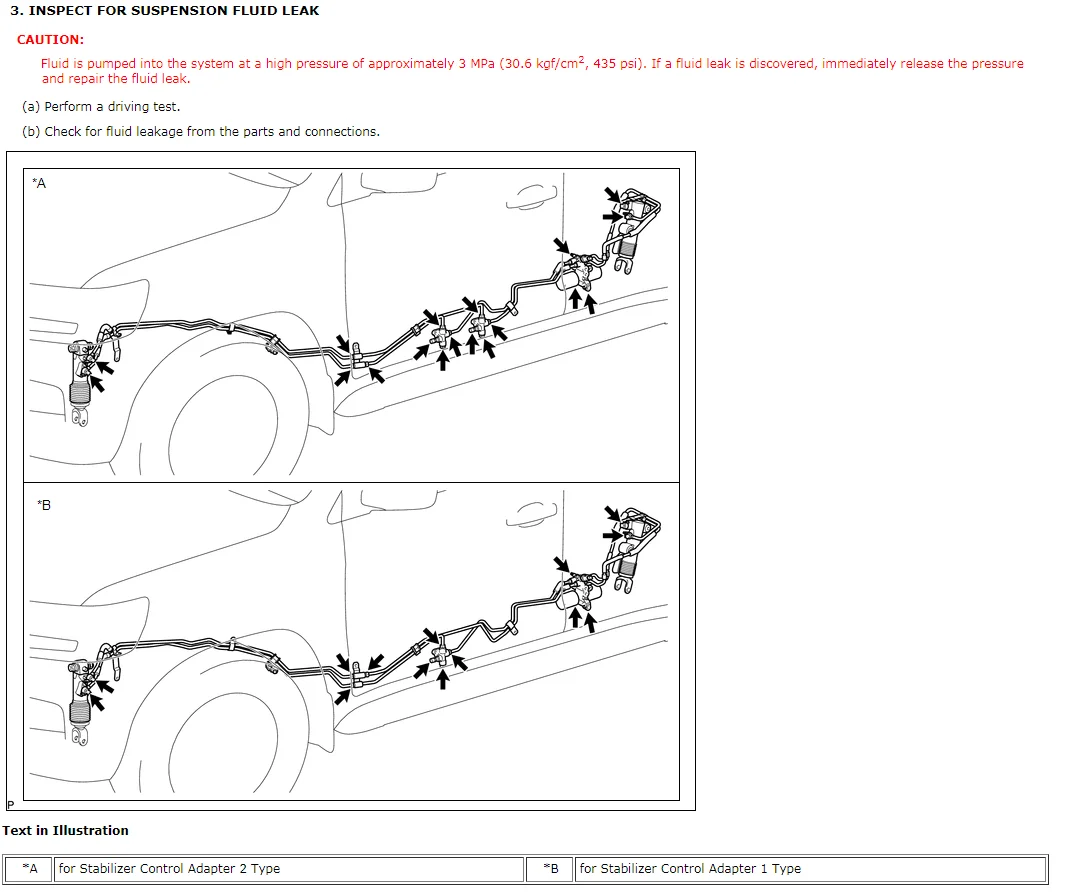

Interesting that it also suggests to bleed air if there is a L/R lean.
