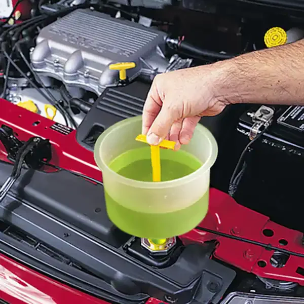

Sounds like there still could be an air in the system. May try using a coolant specific funnel as pictured below. I have found these help during the coolant filling process. You could also rent a coolant vacuum pump to speed it up.
I used the gravity feed funnel and you have to rev to get the pump spinning faster to push out the air. I’d say I spent a solid 15-20 minreving up between 2 and 3 k RPM. The nice thing with the funnel is you can watch the air bubbles come out. Just letting the engine idle wasn’t doing it for me.
