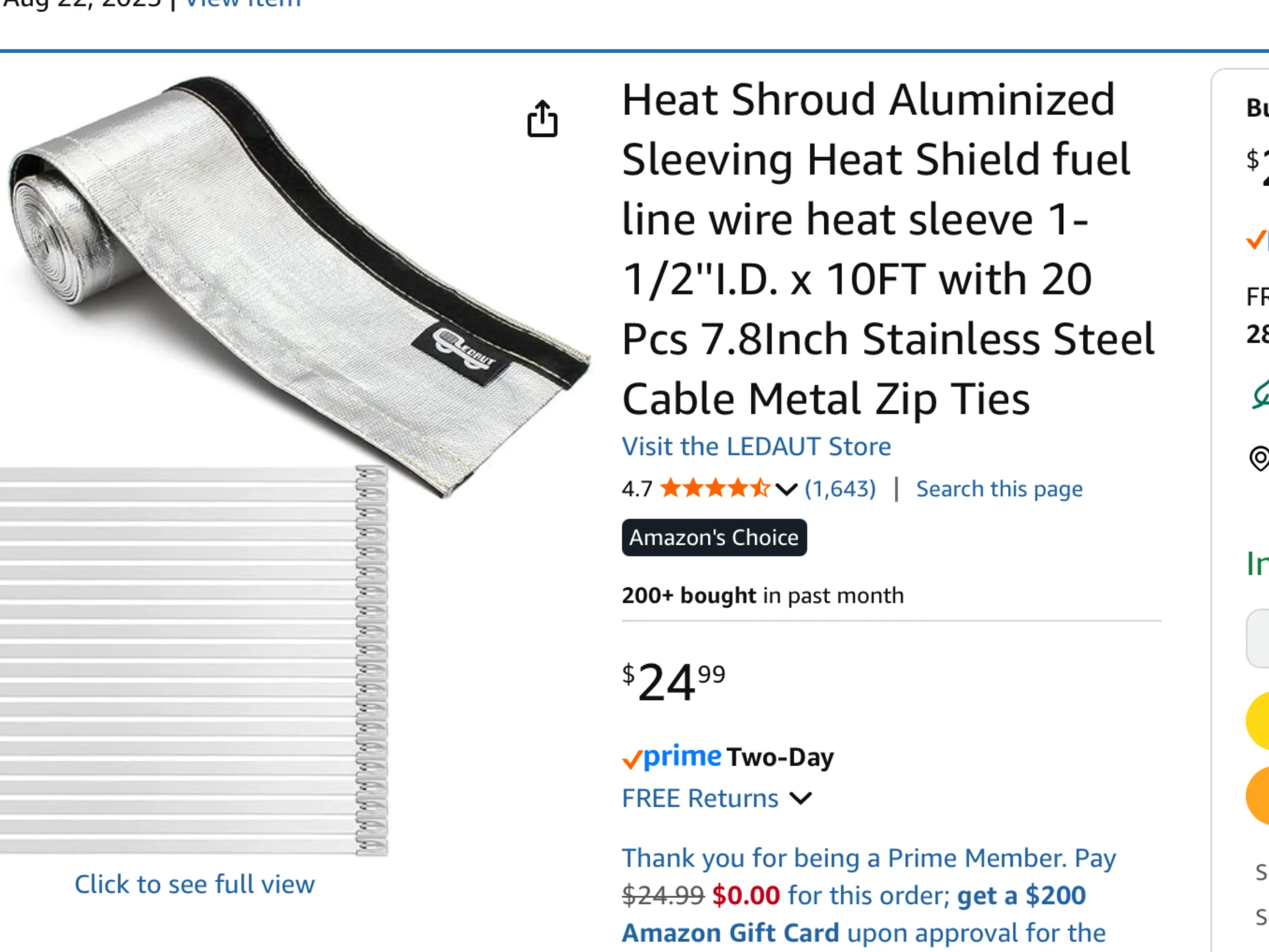

I bought some of this stuff just the other day to protect my fuel line. I got the 1/2 inch size but they have several sizes to choose from.
slightly loose heat sleeve tubing should have better insulating qualities then a tight wrap. The air gap helps with heat.
Heat sleeve with metal zip ties or aluminium foil tape. I'd say a throttle cable is ideal for using a tape instead of a sleeve.
