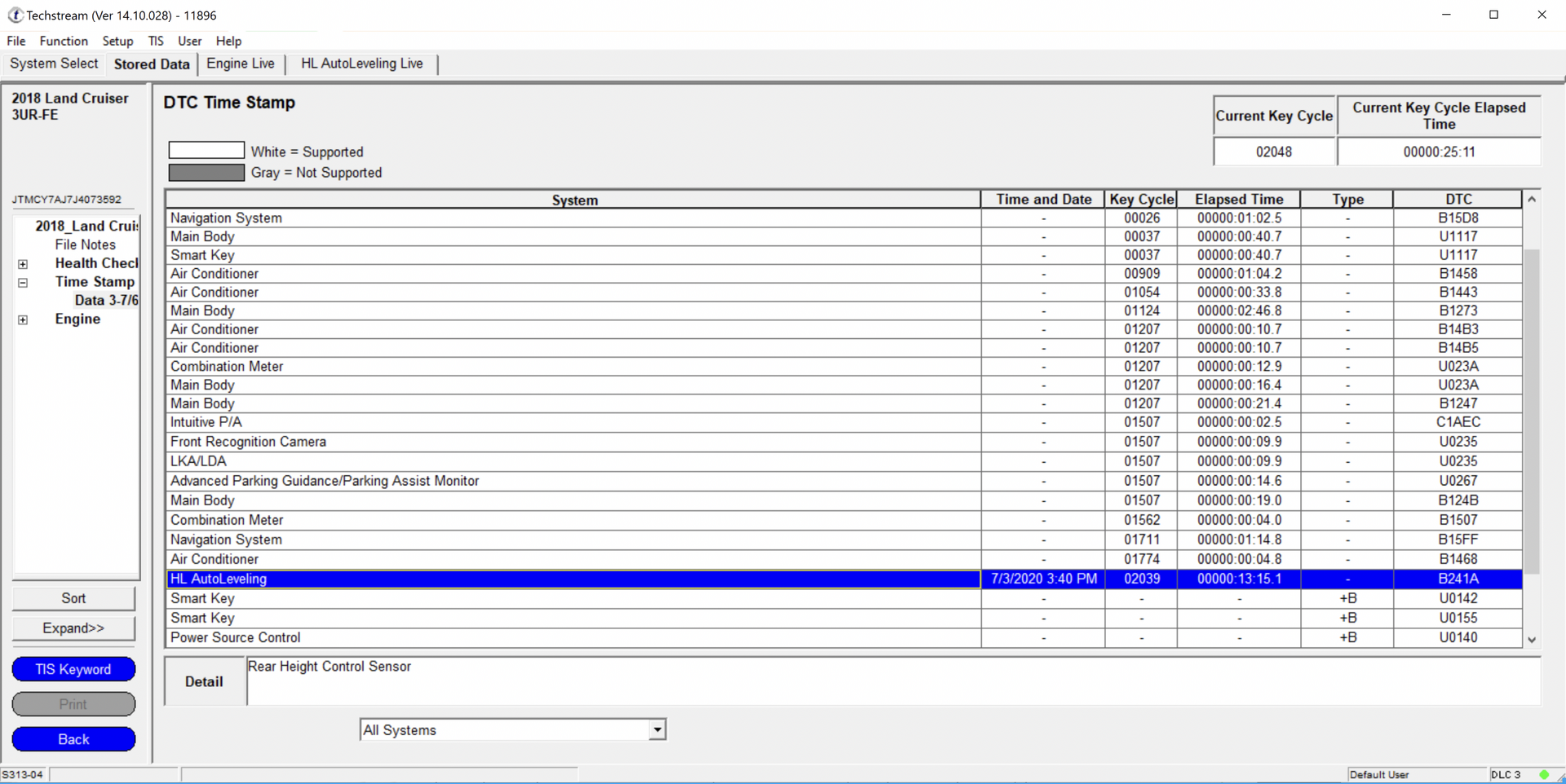

If you have access to Techstream, you could see if there are any fault codes for it.
Example:

Most OBD2 scanners (e.g. OBD Fusion) should also be able show the faults if you don't have Techstream.

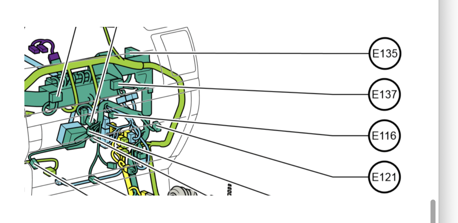

The ecu behind the glove box - interior or in the engine bay? Tks.
The ECU is interior - E121 below on right.
The rear height control sensor is on driver side near rear shock.

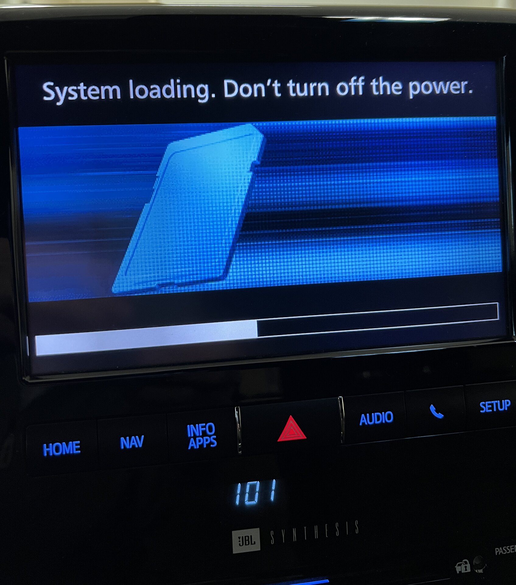

Well battery disconnect made no difference in getting the auto leveling to work. Had this on start up / never seen this message before.
Now what to try??
