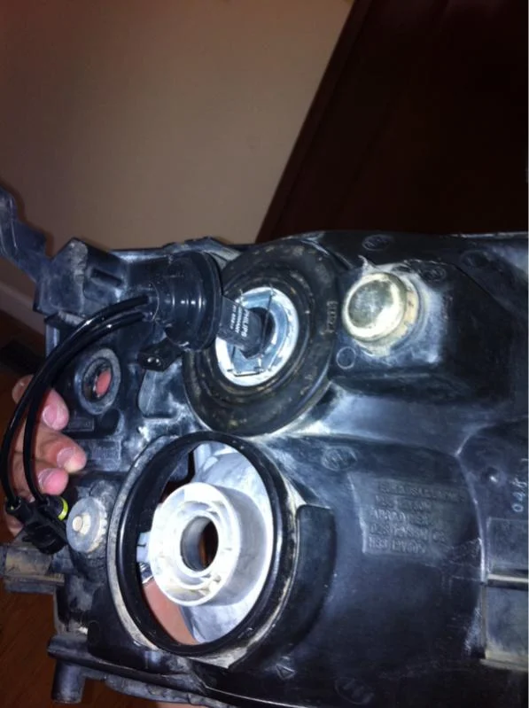

For the life of me I can not figure out how to aim the headlights on my 2001 LC what am I missing here??? I know it should be obvious but I don't see it?
There are small nobs on the back. The top one adjusts side to side, the bottom one (impossible to get to on the driver side) adjusts height. They have caps on them. See photo, one is removed and the other cap is still on.
attachment.php
Thats the side I need to adjust lol... ok I will look again thanks!
