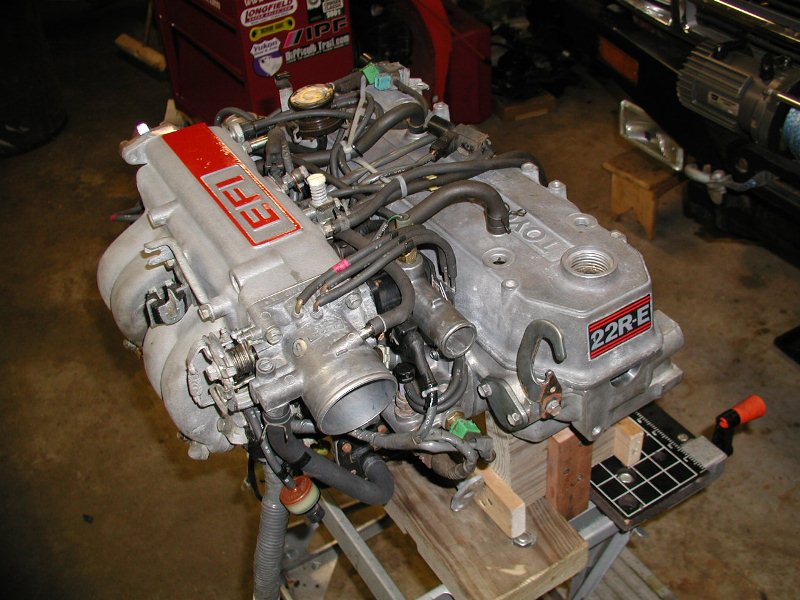

This is why it's sooo much easier if you just pull the harness out of the firewall, pull the intake with the head. Once it's on the bench, then it's much easier to deal with all the intake and wiring. I actually have a jig I made that clamps into a Workmate that I can drop the head on, with both manifolds still installed. I've used that thing many times, works so nice.
There are 10 bolts. One is a long socket head cap screw, should be about 3" long, I believe it is just forward of the thermostat.

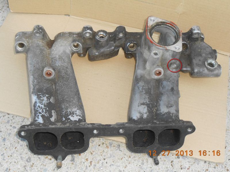

thanks. thats a nice set up. I am nearly to the point of pulling the head to get a better view. A little confused. I have pulled 9 bolts, all 1". I don't see any more near the tstat. Any chance of getting a clear photo of that 3" bolt and where it goes?
Found this photo on eBay, added a red circle where the long bolt is:

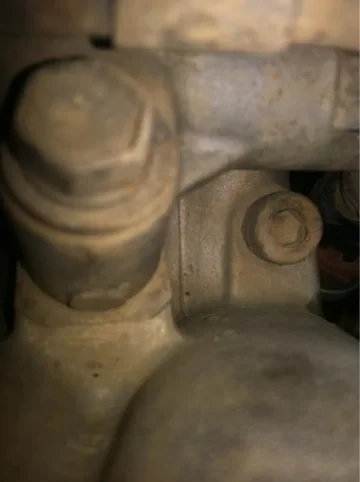

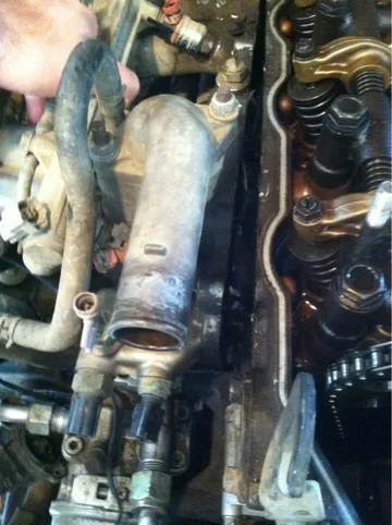

Thanks for that. Here is what I see when I look there on mine.
Busted off? Filled in?

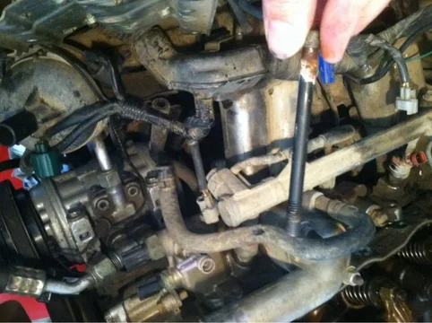

Wait I think that's the Allen bolt!
And there it is. Bolt out. Manifold off.
