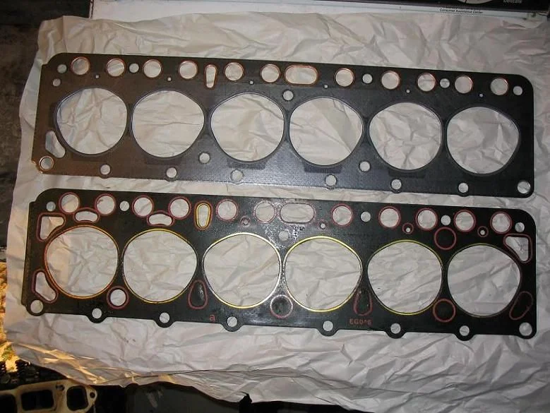

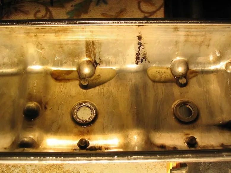

I wanted to share my experience with the CCOT after market head gasket. I recently did a valve job and rings and bearings in my rig and for some reason I decided to use the CCOT gasket kit. Anyway, after a few months now it started leaking coolant into the oil. Notice the milkshake in the valve cover. The compression was still good but it was leaking somewhere between the passages (or maybe the oil cooler...).
The CCOT gasket has a different hole pattern and this is supposed to enhance the cooling. I did run cooler than before the rebuild.
Upper gasket is Toyota, lower is CCOT.

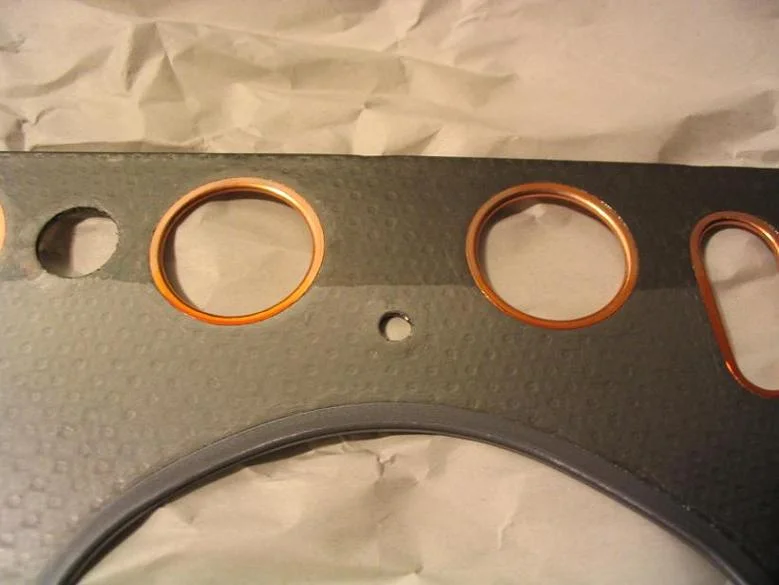

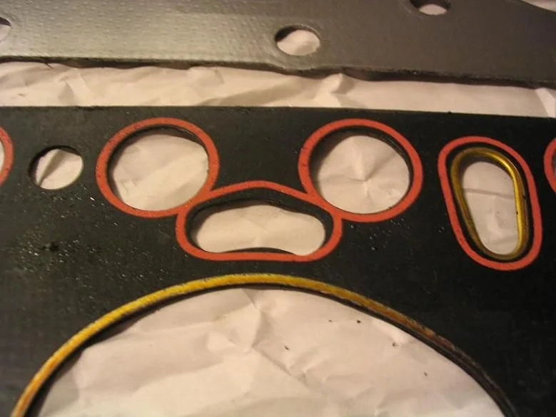

Again Toyota is upper, CCOT lower. The CCOT gasket seems to be made of a paper like material with rubber seals around the holes. The TOY gasket has copper crush washers around the holes and is of much better quality.

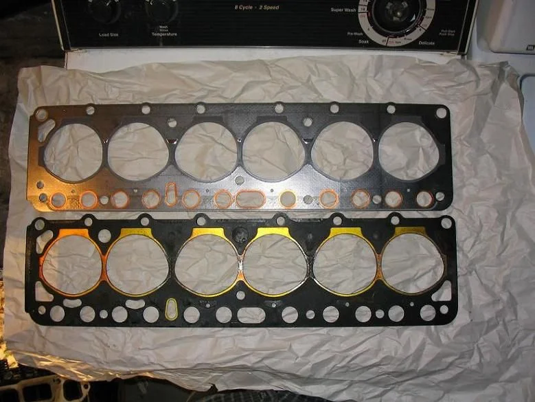

Was the head flat? the pictures of the head gasket show blowby between 2-3 and 4-5(carbon between the cylinders). I have always like OEM over most aftermarket stuff, unless it is real specialized. Hope you corrected the problem, later robbie
all I can say is that I had it at the machine shop and they indicated that it was not warped. They did machine it before the CCOT gasket and check for cracks. I did re-torque the head multiple times over the past few months.
Just took it for a spin and everything seems good...we'll see in a few more days. I'll have the compression checked.
After further inspection of the CCOT gasket and looking at my high-res pics of the head, it doesn't look like these dark spots are from carbon build up due to blow-by. Using a razor blade I didn't get any carbon off of the CCOT gasket in these areas.
It looks like the cheap finish on the metal rings started to burn or melt off where you see the darker sections on the head. I think that it probably would have done this all around the gasket given more time.

Notice on the cheap HG's there are lots of water holes. This is a bad thing. It allows water to move up out of the block, into the head and out to the thermostat. Because that water doesn't travel all the way to the back of the engine, then come up, it doesn't cool the back cylinders and #6 exhaust port. The water is cool, keeping the t-stat shut longer and not getting as hot in general. This gives the mistaken impression that engine cooling is improved. It is in fact the opposite, cooling is reduced. The coolant is removing less heat from the engine, leaving heat around the back cylinders.
Just because the coolant is not overheated, does not mean the engine is not overheating. It just means that there is less heat rejection to the coolant.

Water was probably leaking into the oil at those large coolant holes in the front two cylinders--and I agree the front cylinders would run a lot cooler than the back cylinders.
