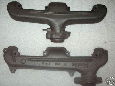

Stock manifold looks very restrictive to me compare to these :D
and those stockers are a lot better than what typically passes for an exhaust manifold
