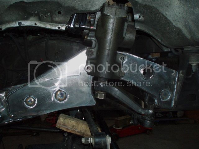

I know of a guy here in NZ that notched both chassis rails to fit high steer and stop any binding, gives more up travel and was running 14" fox shocks I think.
Could be an option. Was alot of work and he said he wouldnt recommend doing it again. :D
Why would you need to notch the frame? that looks like he used a ifs box or something... cant really see from the pics the reason behind it..
Edit i see now. up-travel was probably the goal here yes?
