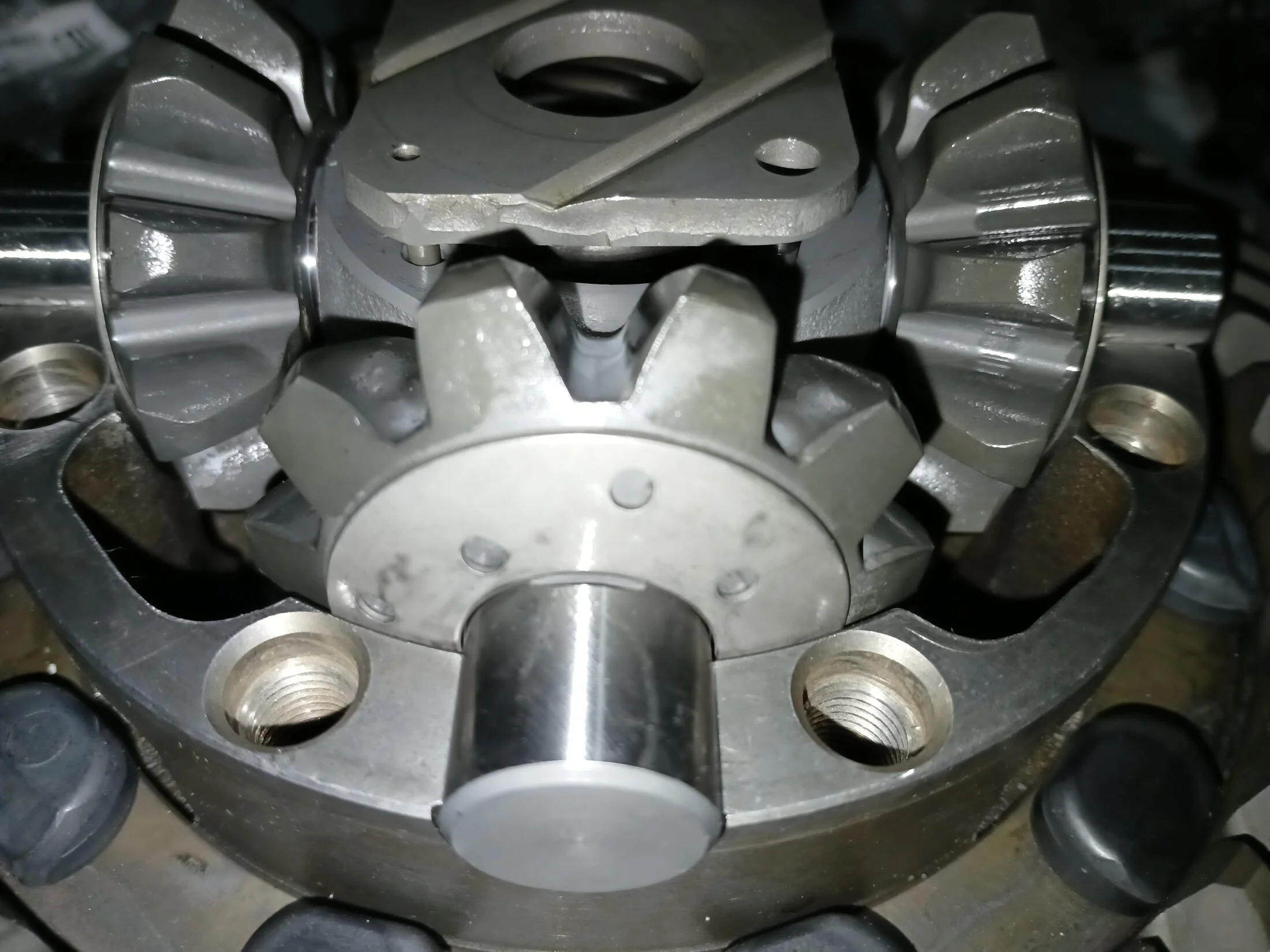

As per the title. I'm setting up a factory 80 LSD with new spider gears, side gears, spide piece, clutch plates, friction discs etc and would be interested to hear another person's experience, particularly what shim thickness they ended up with. following the FSM I'm getting 0.60 mm on each side, but I'm a bit wary about this as another factory LSD I put in came with 0.25 and 0.20 on the sides.
Would appreciate anyone's input if they have done this setup. Not looking for opinions on how good the Toyota LSD is.
