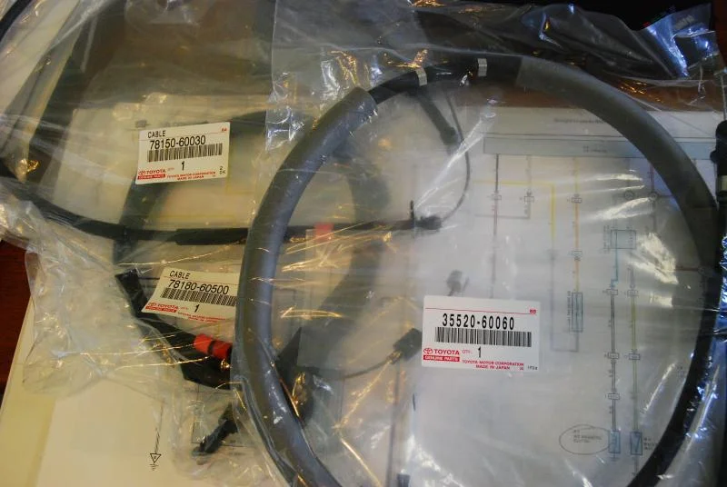

Since i need a diesels spec torque converter i might as well go extreme, oems are the same price. And to change out the throttle cable i need to get to the valve body, so i'll go extreme VB also........woooot:D:D
You'll need different cruise control cable too.
Here are the cables you need, both for LHD HDJ & HZJ
Cheers
Forgot to say, procured the Bellhousing, and cables from Dave Japan4x4, better hurry before the dollar drops even more. I could have bought everything when the exchange rate was 90somthing:1 ended up at 72:1......eeeeek
