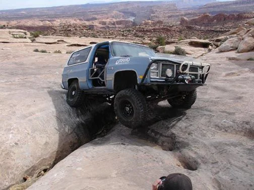

Since we are on this subject,
I am thinking to stretch mine like shown in the photo.
What do you guys think???
That would be sweet! extra cab half top
