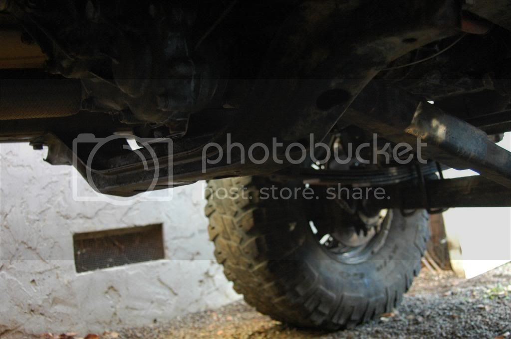

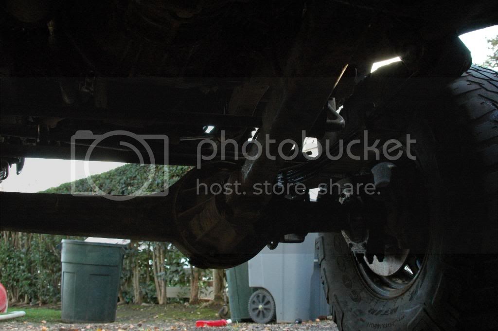

I made this one for my truck after I lifted it, Read up on missouriman's writeup on square driveshafts. pretty simple! but will vibrate at higher RPM.
