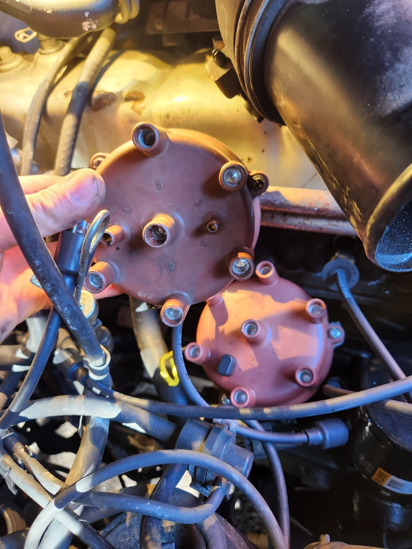

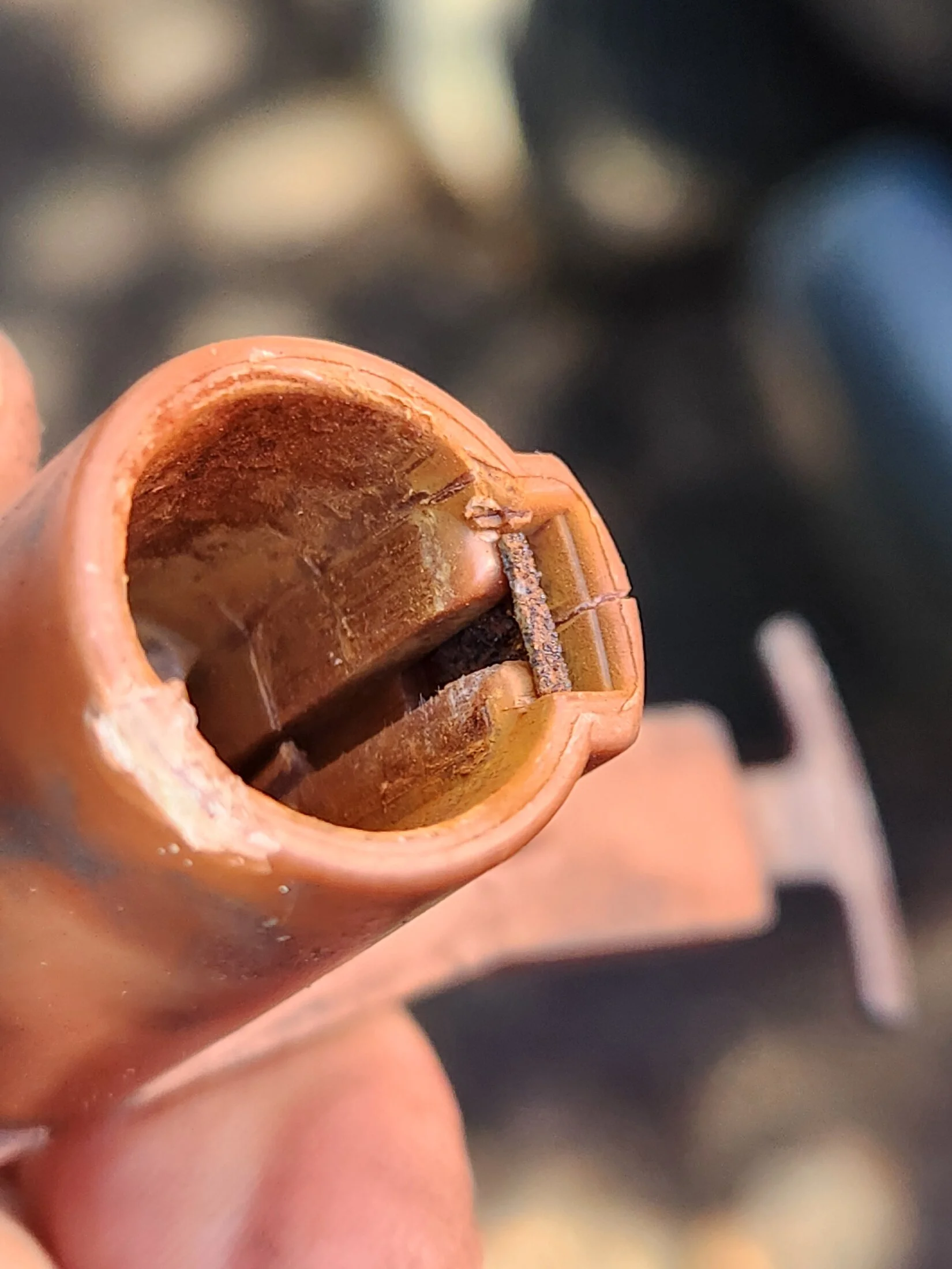

On the other hand, the cap is not looking good so I'm going to replace that, the rotor, plugs and wires, since none of that had been done since we've owned it.

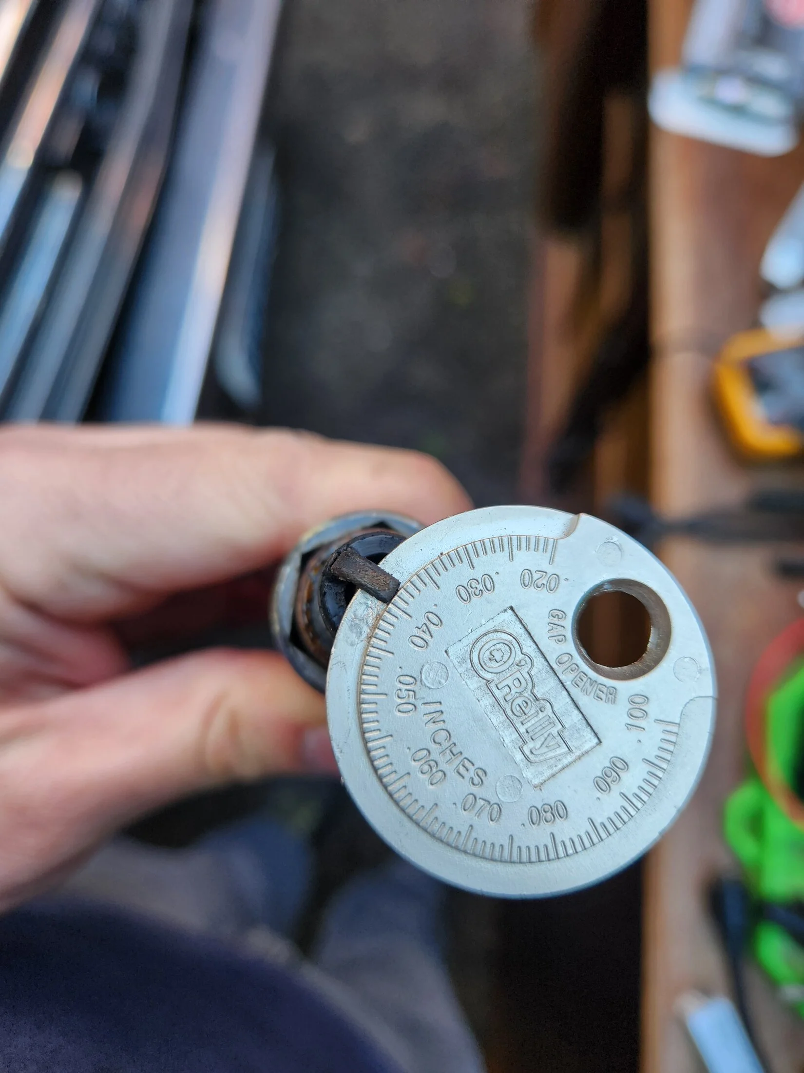

Pulled the spark plug from the rear most cylinder. Totally out of spec. Probably close to 0.038 gap.
Took out the remaining and only #1 was close to spec at about .034
Just realized this, but the new cap only has one vacuum hose connection, and neither the hose from the intake or the firewall connects to it. Does the cap need a vacuum?
Can I just connect the firewall hose directly to the intake?
Well, car starts again. Glad it was just the ignition system being about 10 - 15 years out of maintenance. Only put about 20K on it, but very surprised this wasn't serviced when we brought it in during 2015!
So in summary, hard starting due to neglect ( 10 - 15 years of no maintenance ).
No vacuum needed for that distributor . It is electronic , the advance is controlled by the ecm. The holes are for venting.
Good to know. This is my only vehicle with a distributor so I only know what I've read. Right now it just has a loose fitting cap on the vent hole so it shouldn't cause any positive pressure.
One more thing, the top of the distributor area under the rotor is pretty dirty. Is that normal with use? Does it need to be inspected and cleaned?
While you’re in there, yes, inspect and clean everything up. If you haven’t already, I would strongly recommend downloading the factory service manual (FSM) from the resources section at the top of the page. It’s an amazing, step-by-step resource.
