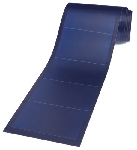

I wish Unisolar made one of their flexible panel rolls that would fit on top of an LC, but their shortest is 112"X 5" which if I'm not mistaken is too long. That one makes 68W. So about half that size would stick right down the center of a cruiser from sunroof to tail and make 34W, which would be nice juice for a second battery. The price would only be about $100, and they're supposed to be one of the best solar films in the business.
You could even apply three side by side covering the whole roof, making 192W, which would power a lot of gear. They're rated for 180MPH winds so no worries driving around with them stuck to the roof. They also don't need to be pointed directly at the sun to make max power, so affixing them to the flat roof is fine.
