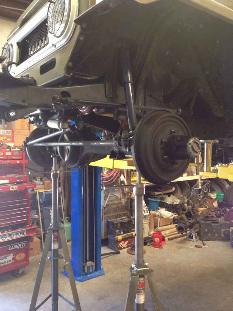

Suspension install weekend with my son

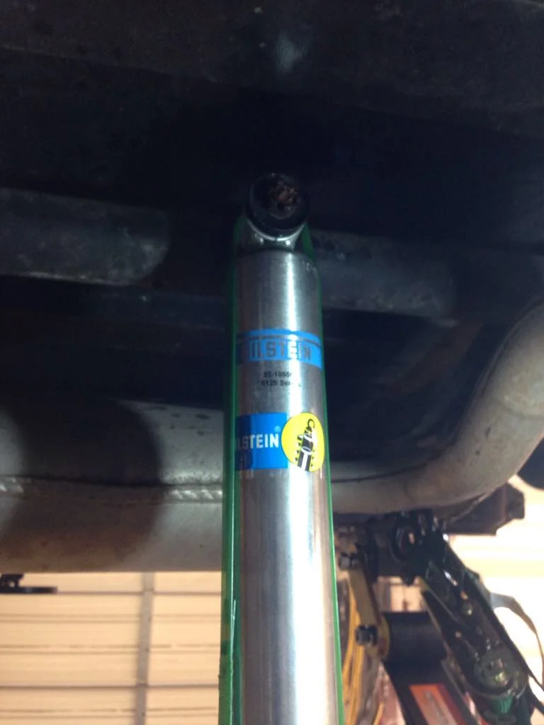

OME 2.5" spring from Kurt @ Cruiser Outfitters. U-bolt flip kit courtesy of Dave with 4Plus.

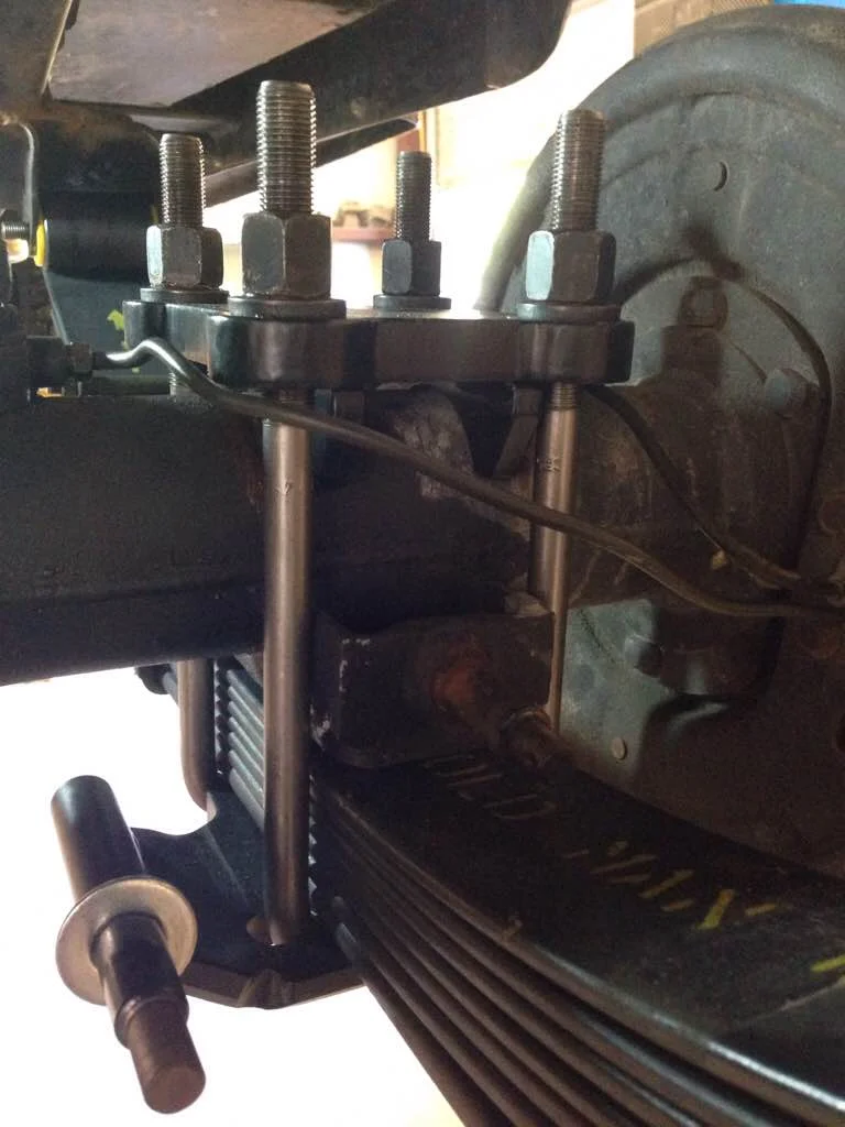

Oh, I forgot the U-bolt removal process.... Ah FIRE!

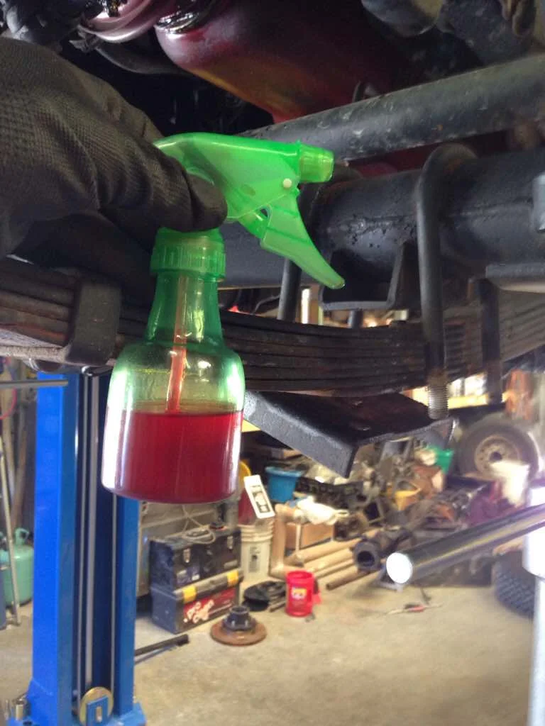

Front suspension disassembly just finished
Used a 50/50 mix of ATF & Acetone for the front u bolts, no fire required.

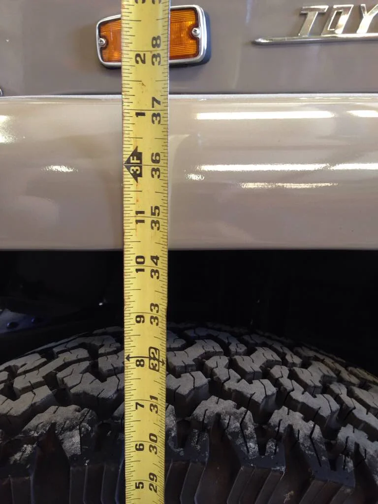

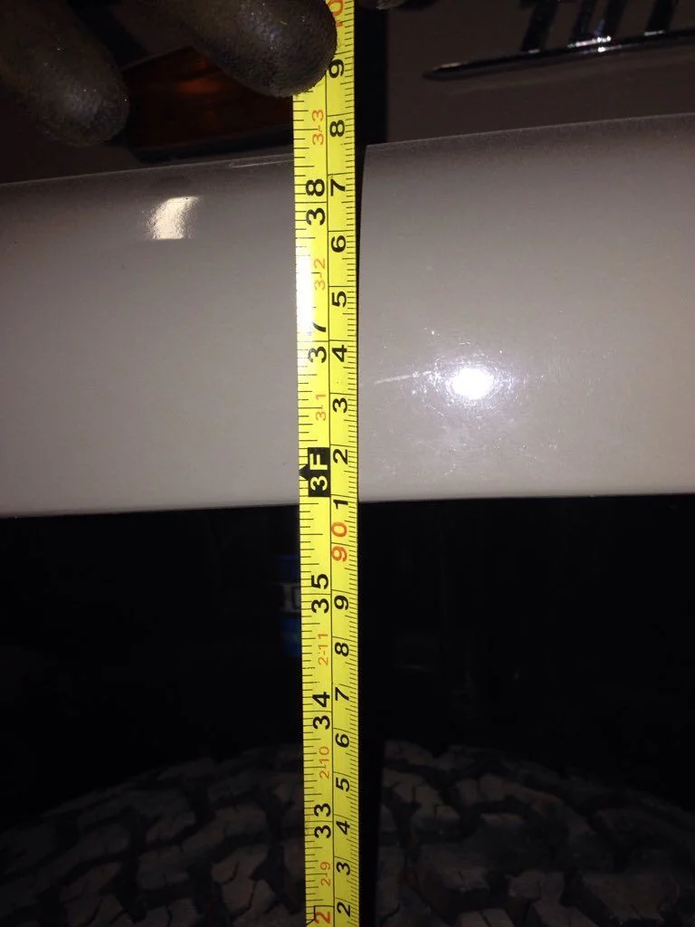

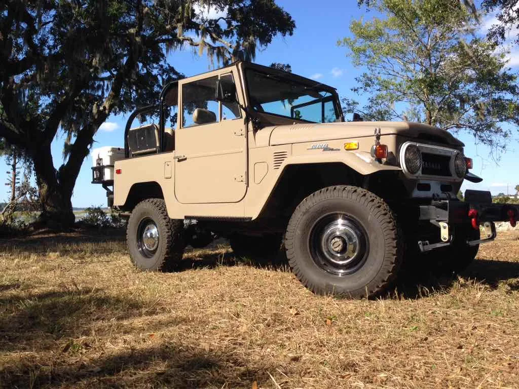

Suspension install COMPLETE!
OME 2.5" Dakar springs (went with HD rear), all new OME greaseable bushings, 4Plus U-bolt Flup Kit F&R, Billsteins on all 4 corners.... WHAT A SMOOTH RIDE HOME! Need to source proper Steering stabilizer mounts and I can install the new SS also.
DS front - before :
DS front - after :
Happy camper here ! Full view photos in the daylight tomorrow.
