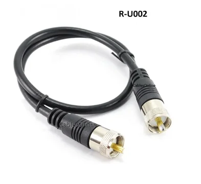

In the interest of quality control, here (first image) is an example of what not to buy. The concept is fine, but this execution is very typical and will ruin the connectors it plugs in to (a radio mfg may void a warranty for this). Note how the solder flows up over the gold plating with a nasty flux residue (dark stuff). Not only does it make the connection unreliable, it fouls and may damage the joining connector by springing it open too far. Third image shows the gold plate as it should look when finished (no trace of solder); and fourth image is of a properly soldered silver plated connector (no solder on the outside of the pin - its all kept inside the hollow).
By the way, good UHF cables can cost thousands of dollars - even used off eBay they still cost hundreds. Home usable cables can be purchased for much less, but expect to pay for what you get - its one of those few areas where time and workmanship still matters.
... cheap F-SMA to PL-259 cable from Amazon - first clue is the bulkhead SMA rather than a cable connector.

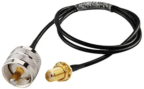

2)
... solder has wicked down the outside of the pin, over the expensive and important gold plated surface
... still has black flux residue which is non-conductive and will fould the mating connector

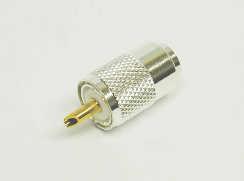

4)
... close up of a properly soldered silver connector: no solder wicked out from the inside of the pin; and residue was cleaned off.
... inexpensive cable from Amazon that shows a good solder job.
