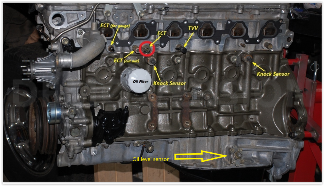

The oil level sensor is not on the front but more towards the rear so when pointed steeply down hill the light will illuminate.
Thank you for that information and image. I only wish my engine were that clean. Why isn't there a Toyota filter on that block? That looks like a Wix. o_O
I know you just borrowed the image, I'm just joking around. And thank you.
