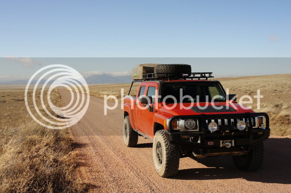

Irrelevant but here is my current truck
Leveled 35" tires front and rear lockers full ucp and reservoir shocks

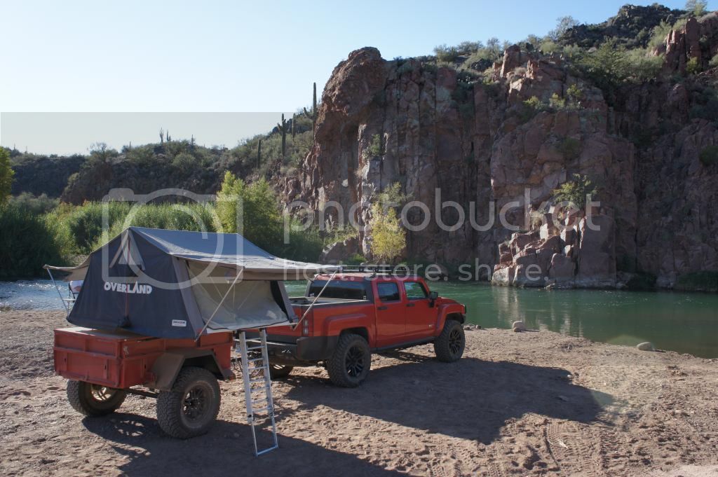

Great to see all these responses! I was starting to wonder if owning a hummer was going to get me completely ignored haha. I will absolutely be reading through those links today seems to be a lot of helpful information here as well as helpful people. Kashmir I will be selling the T before purchasing the LC. It has been a great truck with no problems until a recent front diff issue. In regards to the pictures the first is shot on soldiers pass sedona and the second is a spot in AZ about three hours (off road) south of Prescott.
