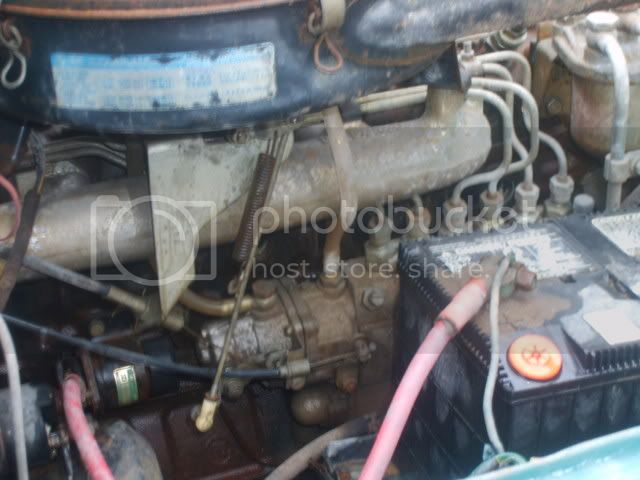

Here are a couple of pics of my 76 "H" engine for you.
I have both a H engine and a 2H they are very similar. Sinse the 2h engine is a 4 litre and the H are 3.6 there are differenses of course, crankshaft, pistons and cyliders are not the same I guess.
I have used a lot of parts from the 2H on my H engine. The exhaust manifoil are nearly the same but do not fit, other than that- I dont know.
